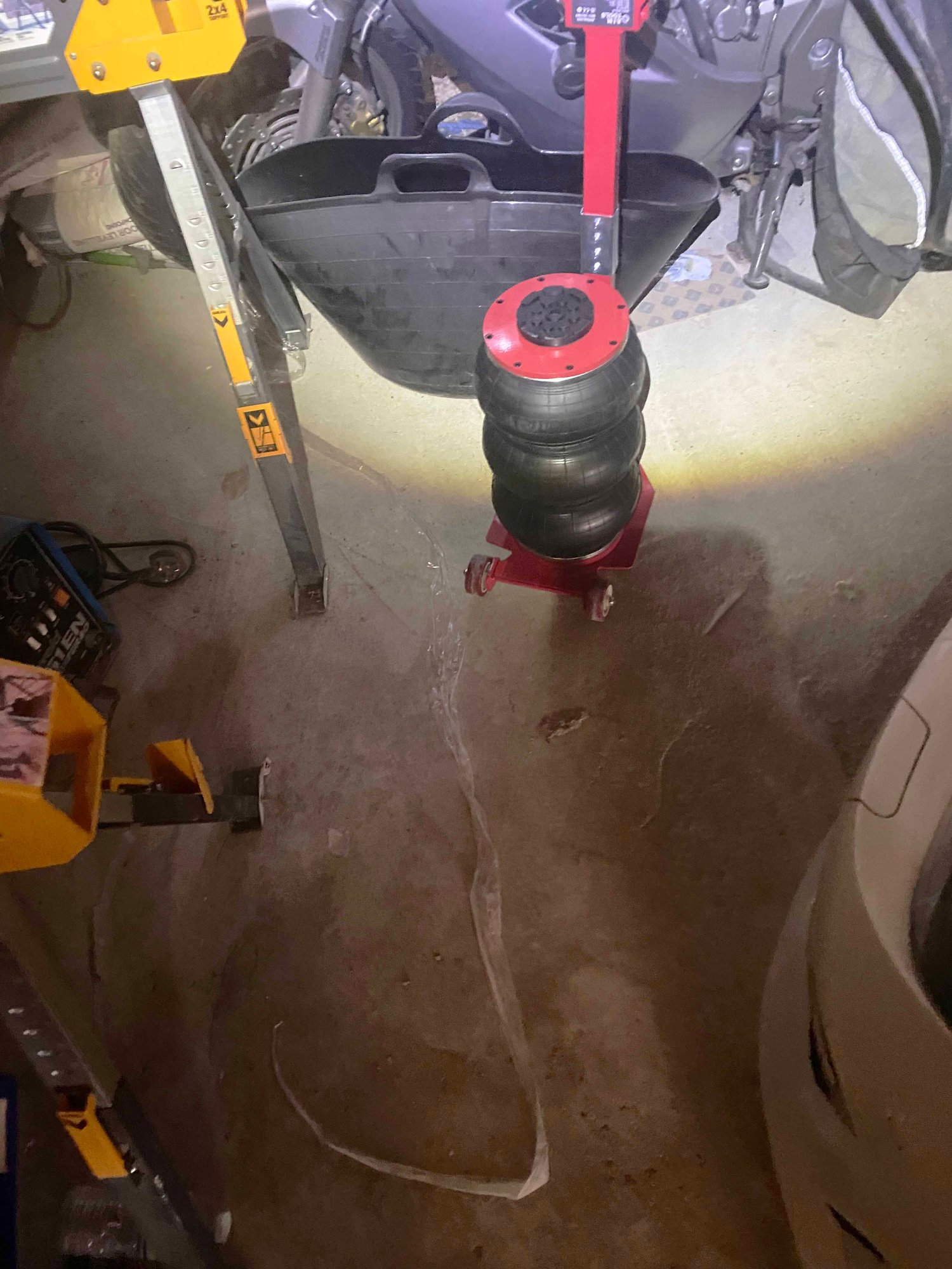

I have bought a small air compressor driven air jack as in future most minor maintenance I will do myself
Its a
Amazon Amazon
and its great 30 seconds later the cars say 40mm off the floor which is fine for changing pads and disks (rotors?)

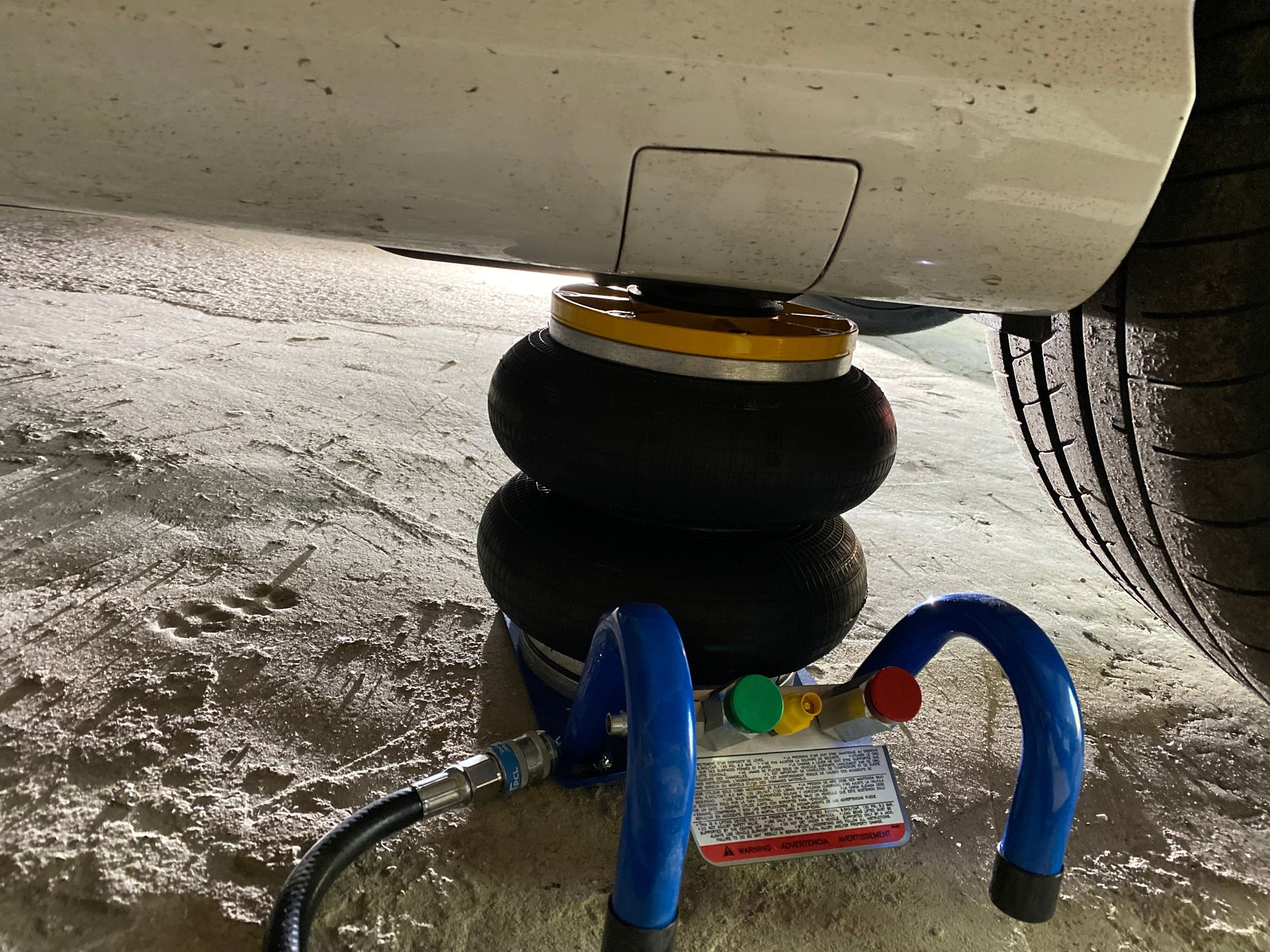

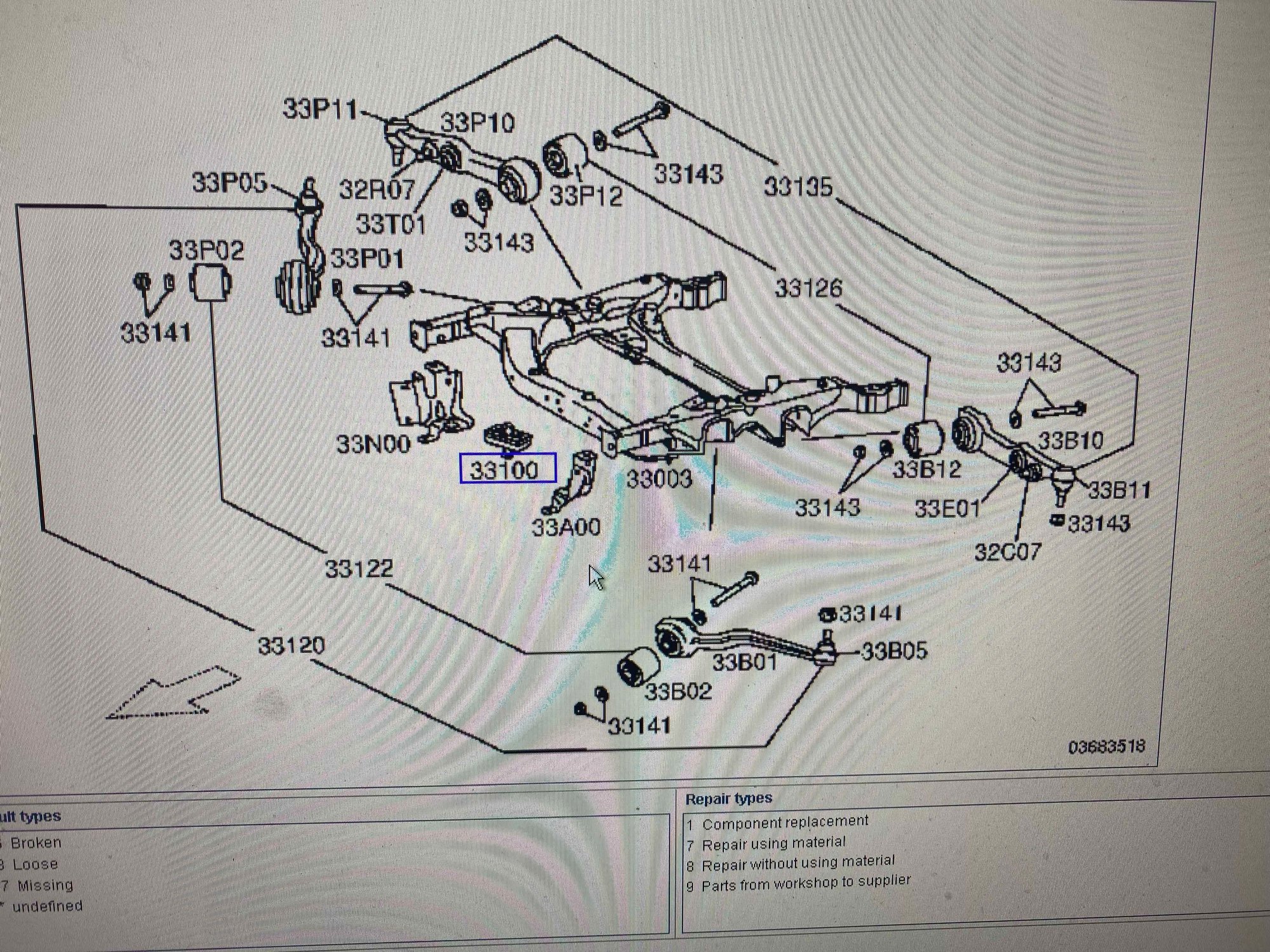

However I seem to have answered my own question for the front single center jacking point
See images below
So that's the location and the clearance below with the suspension raised is 170mm or for you on the other side of the pond a tad over 6.5 inches
From one of those cheap manuals on line it is Part Number
33100 Stop plug under front axle carrier /vehicle jack support point
Sorry about the quality its just a picture of my monitor image
I cannot find similar on the rear in that manual so I guess its the diff or suspension points

Small Update........That jacking point is a minimum of 700mm or 27.5inches from the front of the car to its center bolt and I have another jack on order so its untried

As another update I have bought another air jack the company that bought the other one stopped making ones with long handles in fact stopped
They are all much the same this lifts from 150mm to 400mm and lifts the front effortlessly in 2 or 3 seconds. I think they have a small advantage over my trolley jack as it lifts vertically whereas any trolley jack's arm lifts at an angle and sometimes the wheels don’t move on rough surfaces
However, this Bilbo is hardly small with a 60" chest and that means a very raised car.
My Sealey 3 ton each axle stands raise from 285mm to 420mm but with the jack under the centre lift point the best I get is the low setting and this is too low for me to remove the underside engine pan to get at the drain plug for an oil change being the whole point !
But with 150 x 100mm wood below the jack (see images) there looks enough room BUT the car sits at a rather sharp angle. Wood under the air jack I think safer than on top of a trolley jack ?
However at that angles I would need to lower the car again to guarantee getting all the oil out !!!
Still it proves that jacking point works as the maintenance manual states
