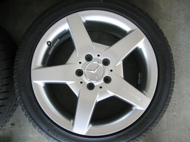

Would you be interested with 17" staggered AMG wheels and tires off SLK350? I might sell this set if the price is right. They had less than 150miles only and the tires are Continental ContiSport2 (225/45front and 245/40rear). PM me if you wanna talk more about this
Thanks
