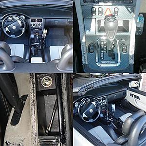

I bought a used 98 SLK with 50K miles, before I bought it the dealer sprayed the dash face pieces, glove box, etc. with a matching gray spray paint which easily scratched off with a finger nail. I removed all the paint and discovered the dash is made of solid black plastic which looks 1000% better then the scuffed parts and won't show scratches. See before/after picture so you can appreciate the change.

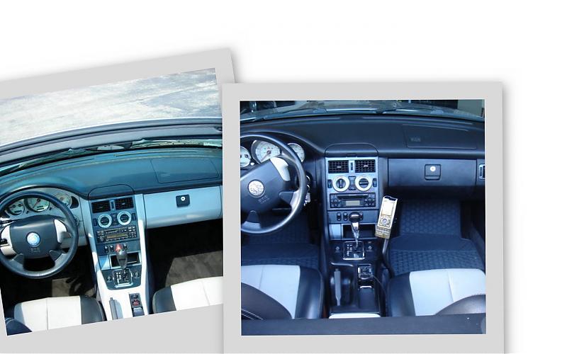

I used this product, it was quick and did not have fumes or bad smell and is a gel so can be brushed on and works in minutes. NOTE of caution, the product will ruin the fake factory carbon trim if left on to long, better to remove parts you want black. Also the edges were tricky, I went over a few times with a course sponge and, used a black sharpie in small tight areas like seams. Also, take the opportunity to use something like amour all on edges before you reinstall parts. Here is a better before and after.

What product did you use to remove it? Also, the plastic underneath appears to be shiny in the few patches where it shows through, how does it look overall?

I used Motsenbocker Lift off Water Gel Based Stripper...Everyone that has seen in person has said it looks 100% better, I agree. The scratches looked horrible.

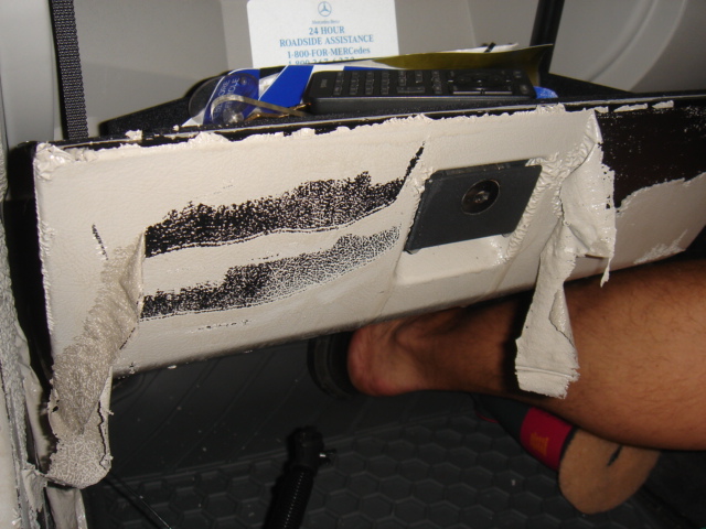

All the paint has been removed, it's true black, the shininess is from my trial and error of what dressing looks the best, but it was temporary and is now even shine and color. Also, a great help was a set of dental tools like the dentist uses on your teeth - it was great at getting the paint out of crevices and a plastic putty knife for the big sections, see photo, paint practically falls off.
