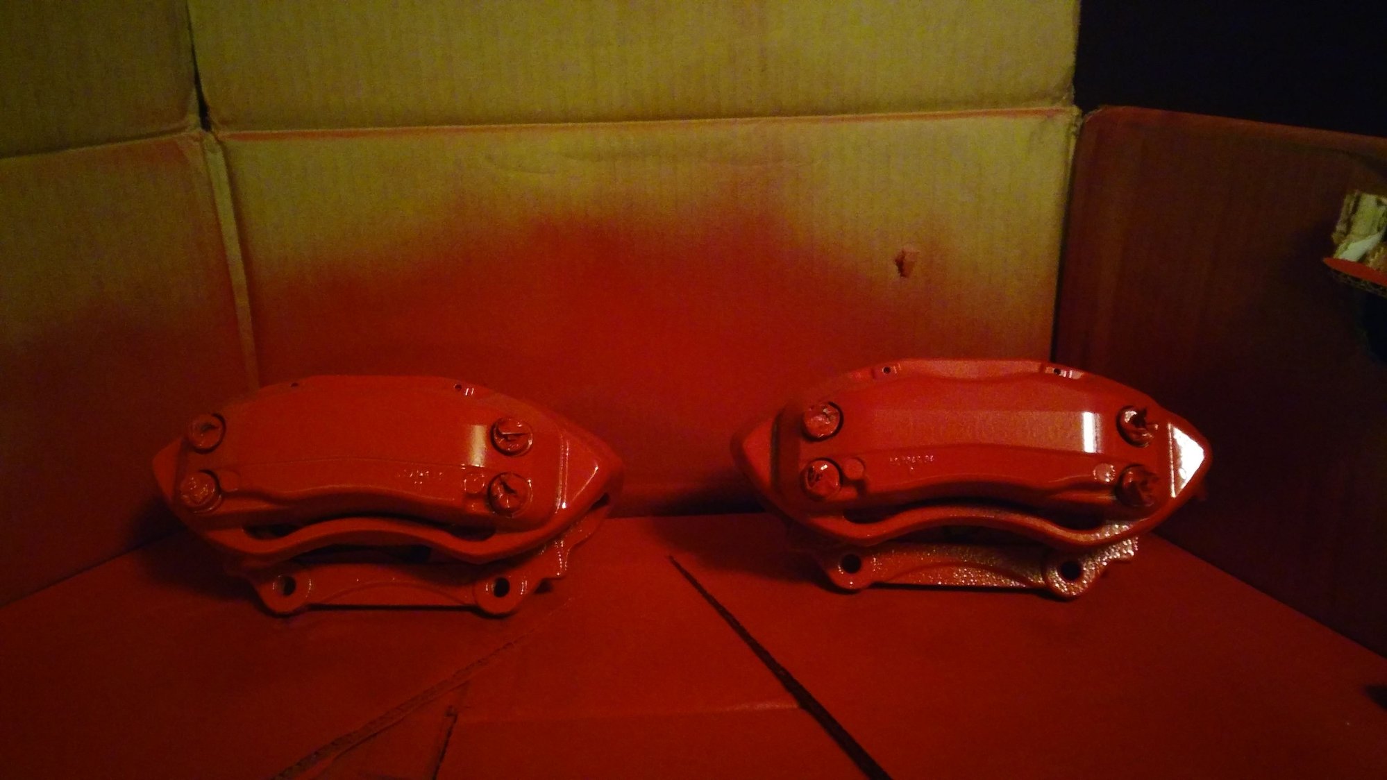

Calipers and brakes are ready to go on
Still debating on Goodrich ss brakelines but I finished the calipers and the rotors are here so this step is complete for now. I will likely wait till I take it down before I put it all on.

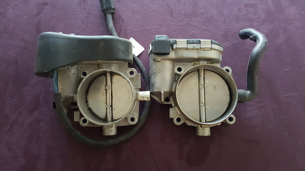

I have kind of neglected my build thread here. I have made a few more purchases in recent weeks in preparation for the build. Once I realized how much it was going to cost each tuning session I decided to shift directions a bit and put together the engine with everything on it that I could afford since it would require a retune each time I added an item that changed anything power wise. So to get this thread up to where I am now here's what I picked up.
An 82mm throttle body (on the right) for the increased air I intend to flow

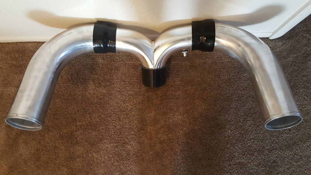

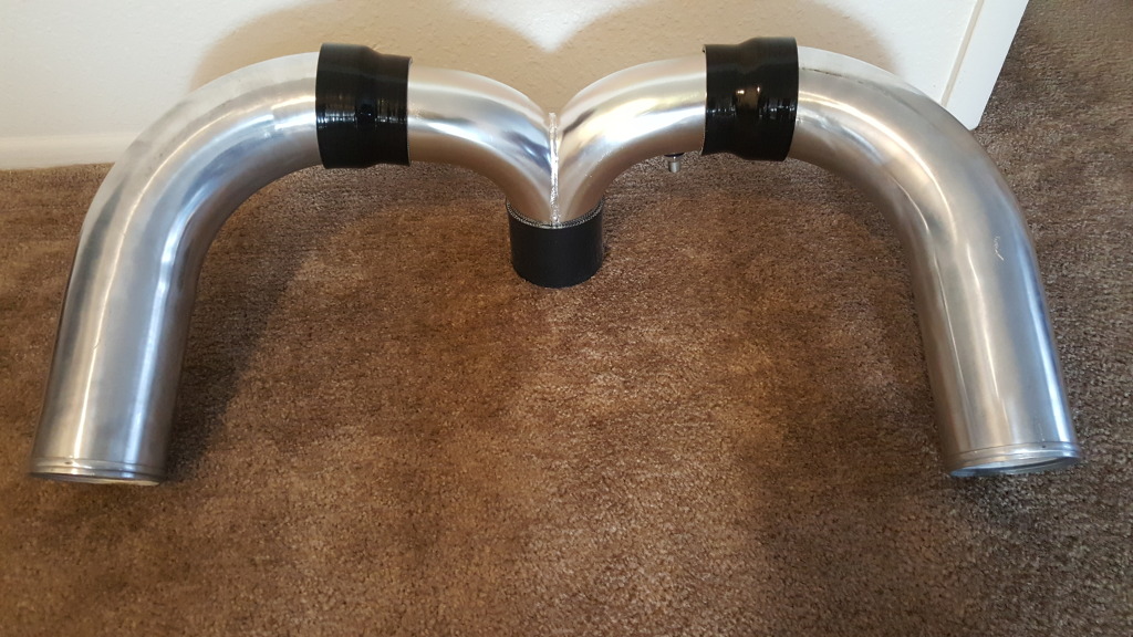

I will be building a custom intake like the others I have seen similar to the needswings setup. So I picked up a y pipe.

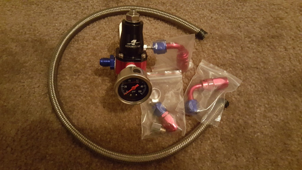

Picked up a aeromotive for for the additional fuel requirements and a Bosch 044 fuel pump (no pic of it at the moment) I do intend to split the fuel rail to get better equalization in the line and I will likely loop it just because my Legend was.

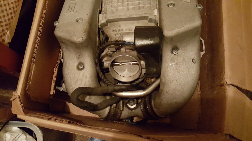

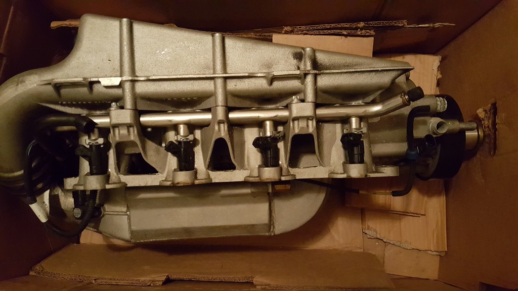

I was able to score a great deal on a supercharger fully equipped with everything but the SC pulley which was okay because I knew what I wanted and it was not a stock pulley.

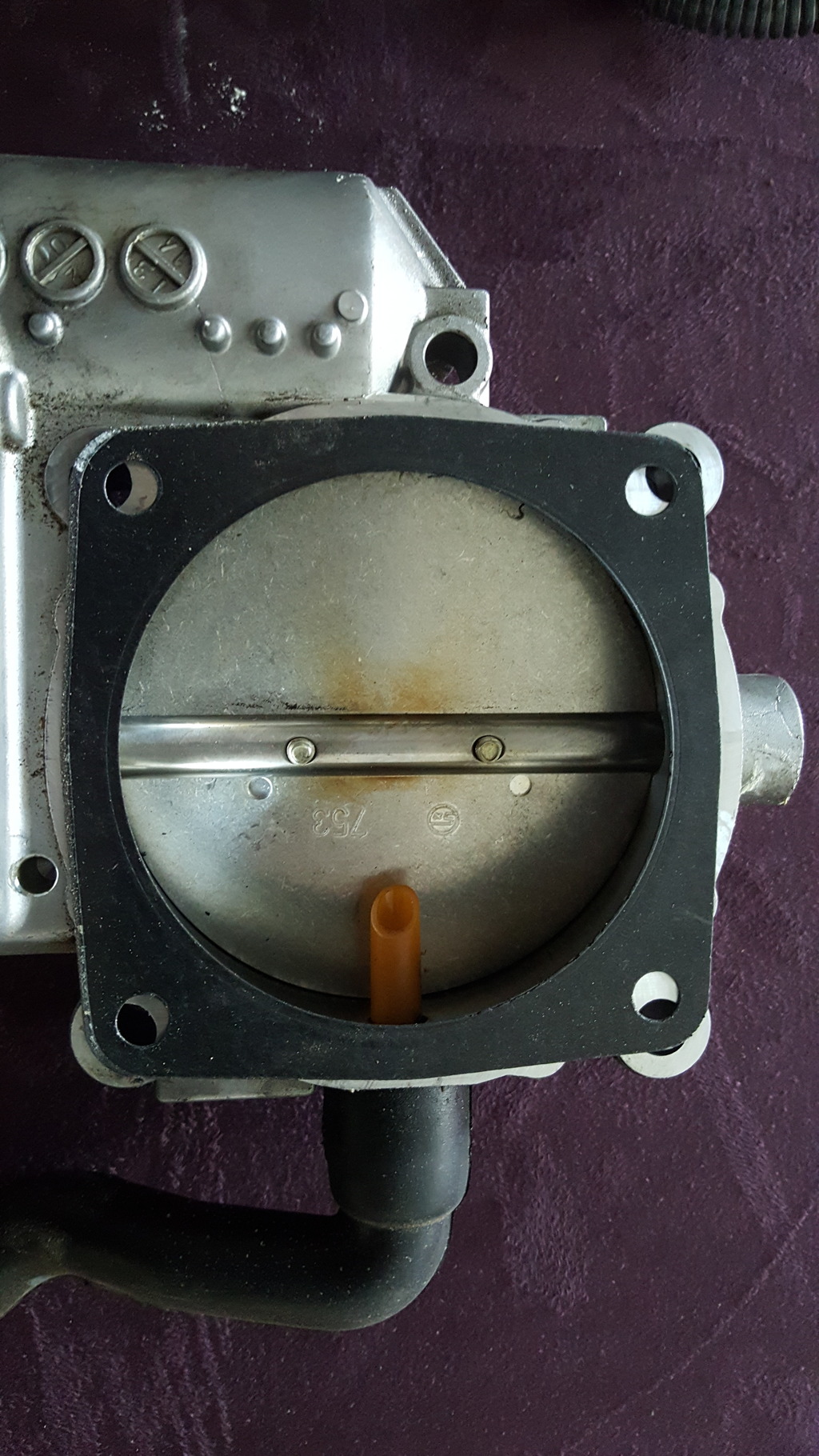

Made another tune impacting purchase in an effort to not have to re-tune the car multiple times before it is where I want it. This one is the 82mm throttle body. If I upgraded later it would require a re-tune. I won't get a baseline but I will save a lot of money in the long run this way. Just a few more items before I am ready to end the purchasing phase and jump into the building phase.
Pics of the 82mm throttle body.

This is a pic of the mounting difference between stock (Tb gasket) and the 82mm throttle body.

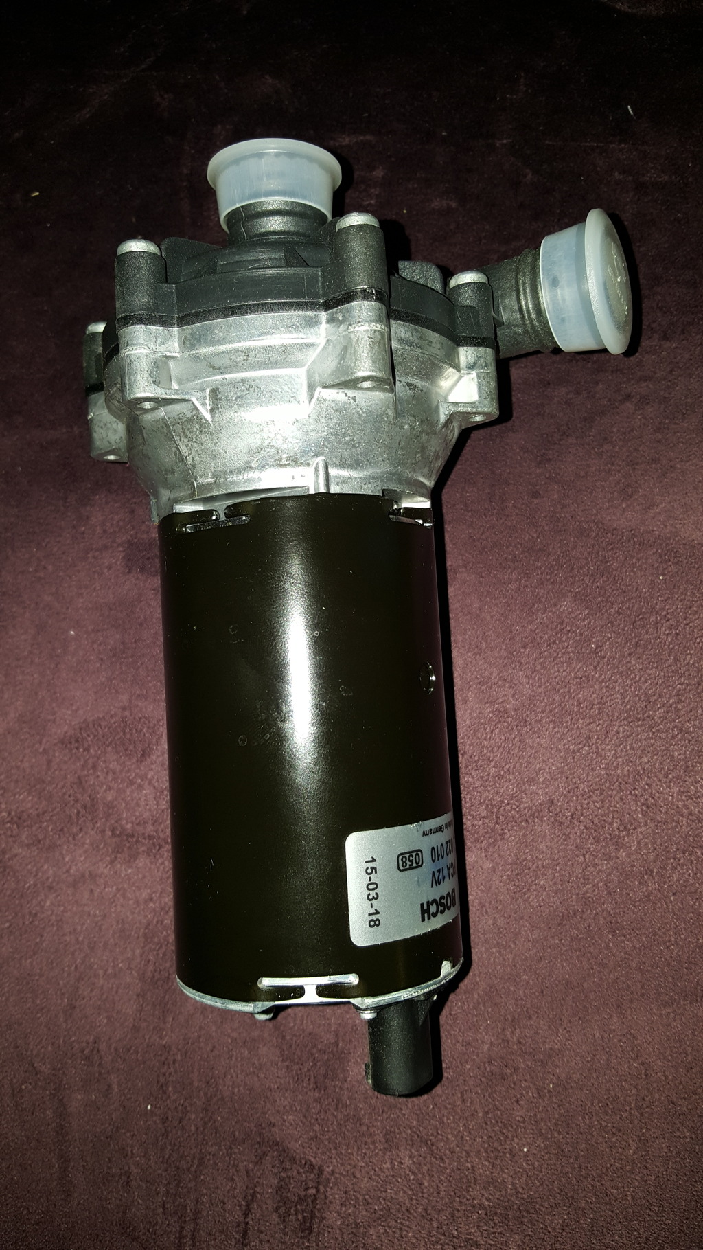

Finally got the correct intercooler pump

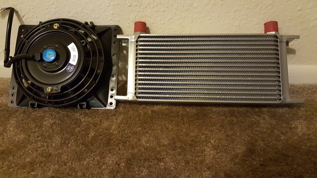

Also had the oil cooler come in and an aux fan that I am not sure where I will put yet.

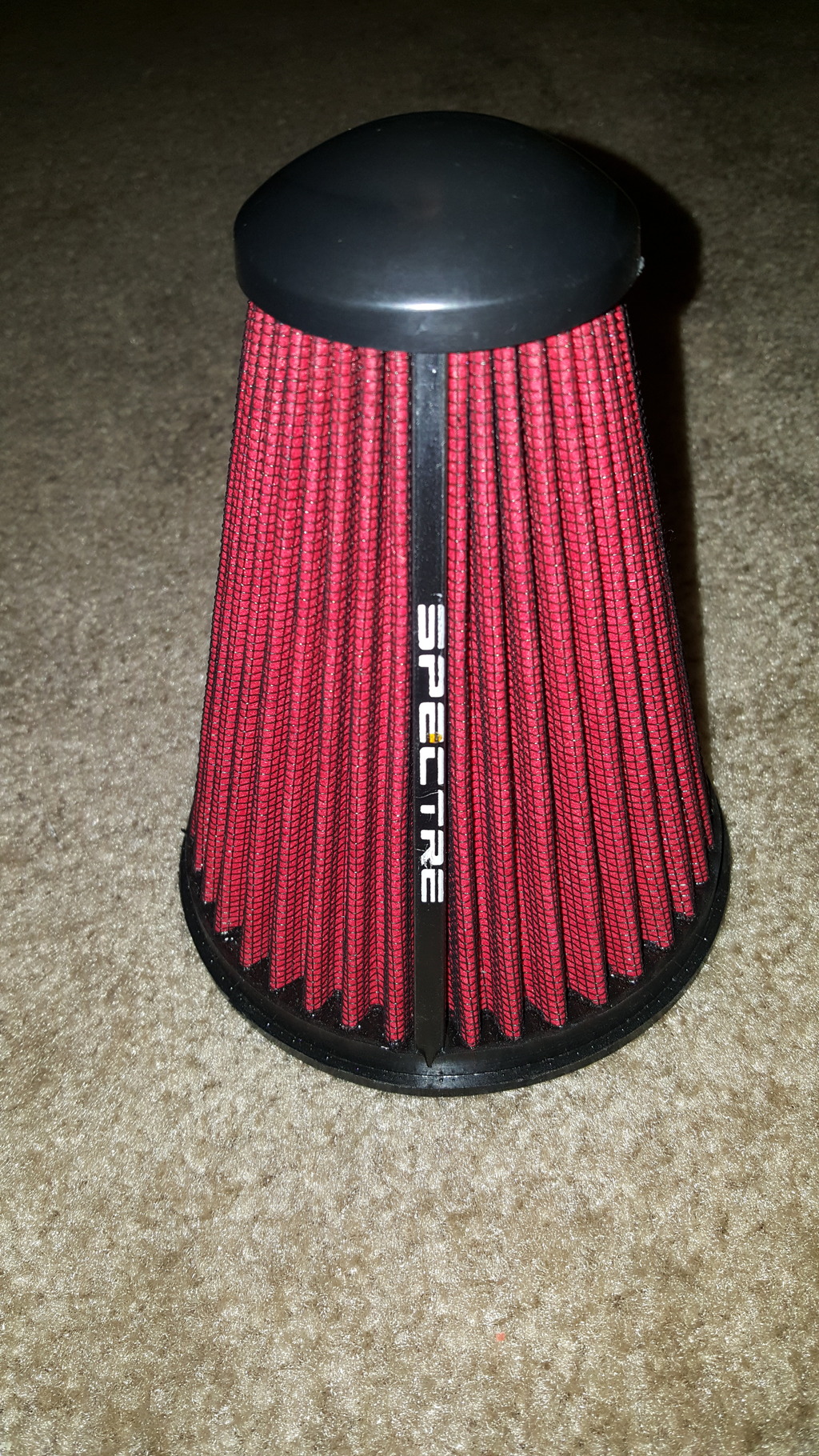

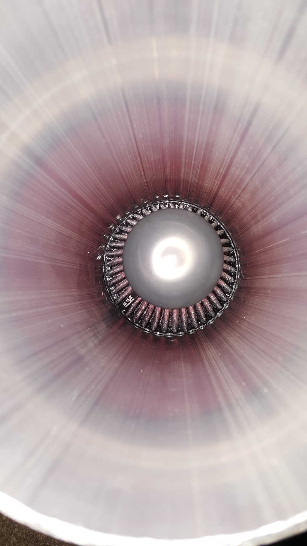

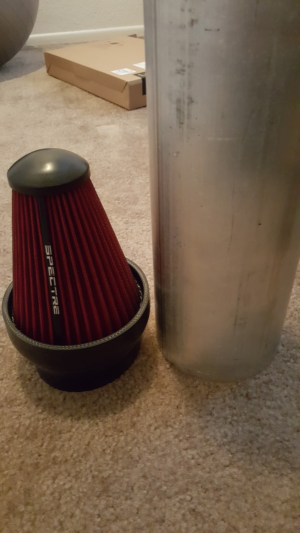

Here is a few pics of the 4" to 5" transition with the 5" spectre filter(s) in it. I am glad this actually worked the way I expected since I only saw one pic on the net that indicated that it would. I am not concerned about the looks as it will be covered by shielding or paint. More of a sneak peak really.
