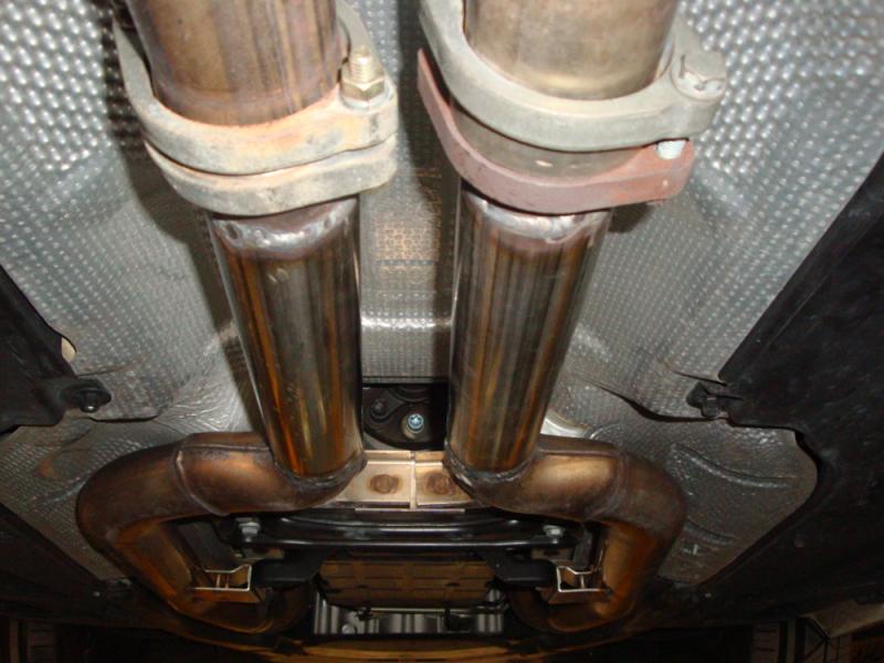

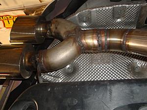

Well, I decided I needed a bit more growl, so I deleted the 2nd CATs. Previously, I installed an x-pipe and removed the rear cans.

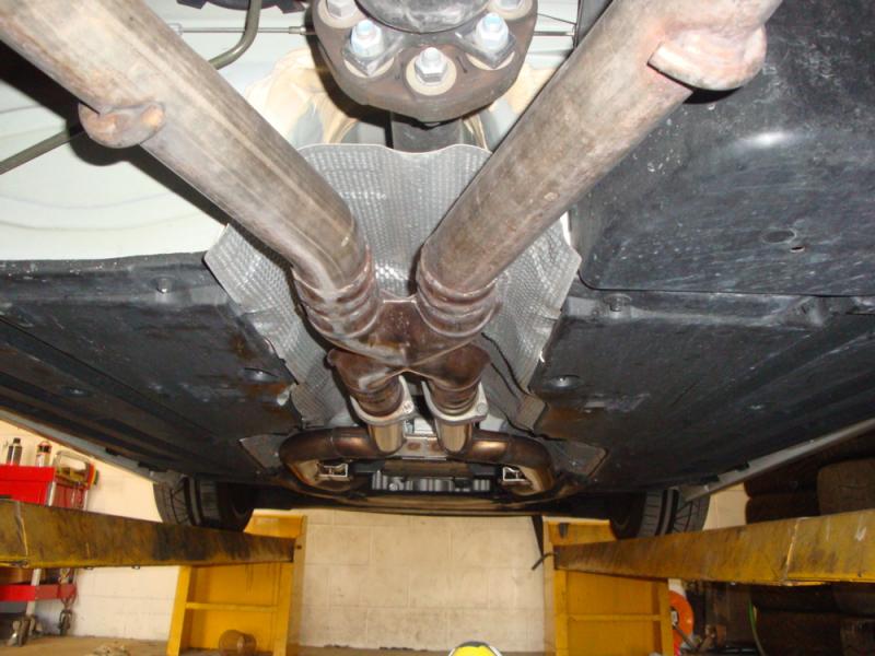

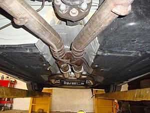

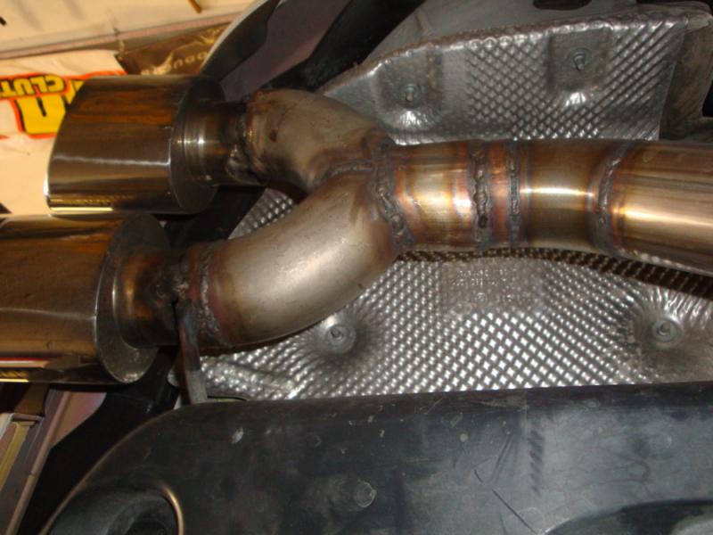

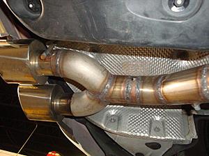

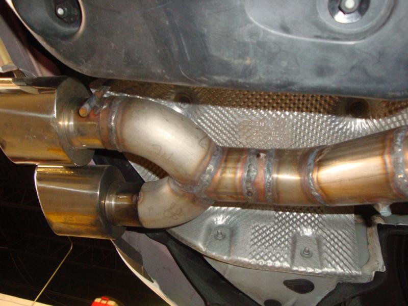

lsufan's Avatar
Joined: Jun 2008
Posts: 126
2006 SLK55
Here are some pics of the underside.

Old Mar 4, 2009 | 08:51 AM
lsufan's Avatar
Joined: Jun 2008
Posts: 126
2006 SLK55
Never touched primary CATs, only 2nds which are only put on vehicles b/c CA emission laws need them. Primaries meet federal guides. The 25K fine is for dealers, not individuals. Individuals face potentially a $2500 fine. As the post 02 sensors are only post primary, I don't think MB would design a car wherein 2nd CATs are functional to federal standards. Did I mention my Benz is for racing only?

by rear cans removed do you mean mufflers? and you running wtih no muffler? an xpipe in place of the resonator right?
do you stillg et that da da da da da da da sound?
thanks

Old Mar 12, 2009 | 08:24 AM
lsufan's Avatar
Joined: Jun 2008
Posts: 126
2006 SLK55
Yes, no mufflers, xpipe for resonator, and 2nd CAT delete. Winding it up in 3rd gear gives some nice pops and girgles on decel, but I was hoping for a bit more. The header and primary CAT are pretty restrictive. However, even Brabus, Renntech, and Kleeman say not to touch the primary CAT b/c of post primary 02 involvement in ECU mapping. So I left them alone. It's crazy loud at WOT. I'll try to get some vids this weekend of it under load with the top down.

Old Apr 30, 2009 | 03:59 AM
linh811's Avatar
Joined: Mar 2007
Posts: 15
what is the specific model number of those magnaflow tips?
