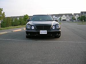

what do you guys think?

looks nice !!!
did you just take your stock chrome grill and have it painted ? flat/matte/gloss?
did you have factory xenon's ? was the retro fit hard at all ?
Reply 0
Aug 18, 2010 | 10:05 AM
i had the stock grill painted- i looked all over a could not find a black grill.
the depo retro fit is not hard, i used my stock bulb, ballast, and headlight harness. i got a pair of hella projectors and it went together nicely. the depo are almost an exact copy of the oem hella headlight. the ballast even mounts to the depo in the factory location on the bottom.

daMN thats a good look. can you post a 3/4 view from the front. i would like to see how the lights look from an angle. grill looks great!

What kind of paint did you use? I am about to do this and hopefully mass produce it however I am not sure what paints will look best.. I'm thinking of doing Matte black or piano black, however I fear that they will scratch due to road conditions and gravel. Any advice would help!

Are the Hella projectors you used bi-xenon or fixed shield (or no shield and you've got clean light but it projects really high)?

Quote: What kind of paint did you use? I am about to do this and hopefully mass produce it however I am not sure what paints will look best.. I'm thinking of doing Matte black or piano black, however I fear that they will scratch due to road conditions and gravel. Any advice would help!
I've painted the grill on mine with various types of paint but after a while they would all chip.
I recently painted it with a dupont spray that has rubber in it, i forget what it's called but it makes the paint more elastic and it holds up the best compared to the other paints i used. It doesn't look bad either, it sort of has a flat black flacky metallic look to it.
Reply 0
Sep 13, 2010 | 11:53 AM
the projectors are bi-xenon from a 07 5 series bmw, but i did not wire the motor for the shield yet. at first they were aimed high but i adjusted them.
the paint on my grill does have some rock chips - if anyone has a good solution let me know.

Spray paint is a no no and will chip..
I have my grill wrapped up in the 3M carbon fiber vinyl wrap thingy and there will be no chips and will last long. IF you want black, they have black vinyl wrap thingy too..

Question... I plan on changing my headlights. So you used all the OEM stuff? Stock bulb, ballast and even the headlight harness? Can you give us a break down on this. How to?
2nd do you have a link on where you purchased the depo lights?

headlights- ebay auction #400145977058
i used all the info i could find on mbworld- baked them, pulled them apart removed depo projector, used rotary tool to shape inner headlight housing and mounted the bmw 5 series hella projector. i also used my stock bulb, ballast and harness. the depo is almost an exact copy of the stock hella headlight so the stock ballast mounts to the bottom of the depo unit perfectly and the harness is easy to remove and transfer. i also painted the trim piece around the projector black(it comes chrome from depo)

I hate to keep beating a dead horse on this, but is the reason the depo projector ones with the hid's already in and prewired with ballasts DON'T work or aren't recommended for "plug and play installation", because the projector in it actually sucks and doesn't cut off or aim well. So therefore it's recommended to replace the projector with a "real" projector?

depo projector= not so good

Thats pimp work yo .. Did that once to my R1 headlights .
Did you bake them again to seal after it was all put together?
Reply 0
Sep 20, 2010 | 06:44 PM
yes, you have to bake them before they can be re-assembled
