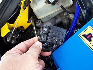

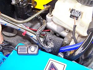

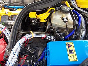

that makes sense as all of the sprint booster and pedal box installs I have seen on the internet have been on 2002+ models. Can you take a pic of your install so we can see how you have yours installed
Old Sep 24, 2012 | 01:21 AM
cm60k's Avatar
Joined: Aug 2006
Posts: 7,053
Likes: 398
From: A.D., U.A.E
Sure:-
Pedalbox vs. Sprint booster, a no-brainer!-picture-181.jpgPedalbox vs. Sprint booster, a no-brainer!-picture-182.jpg
