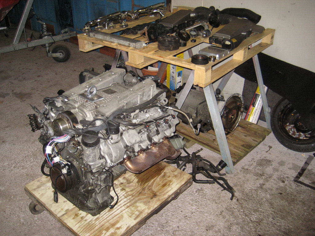

Back to my "Project":
There might be a "little" update the next weeks
- S/C Engine
- 172mm Pulley
- 82mm Throttle Body
- New Headers
- Complete new Exhaust with 89mm diameter
- CLK-DTM Renntech Software for the Engine to fit the Transmission Software well
Engine came from a RHD UK S55 i bought 2 weeks ago. Nice car but steering wheel on the wrong side ... but that makes it cheeeeaap
greetings, Fabian

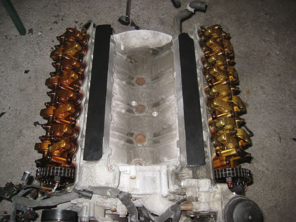

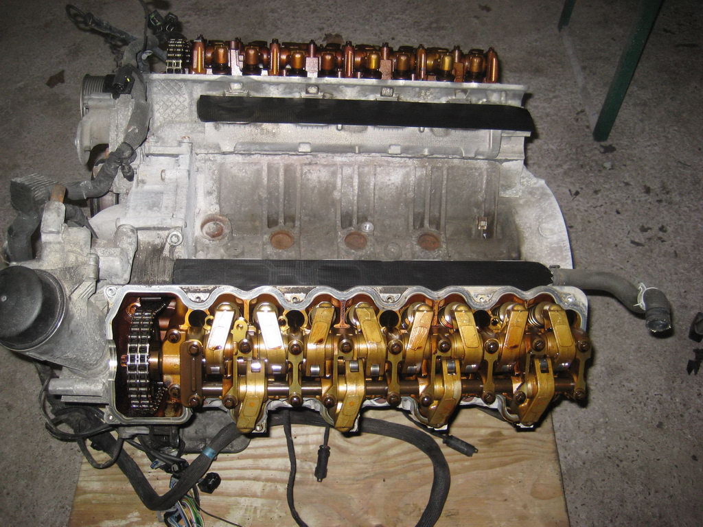

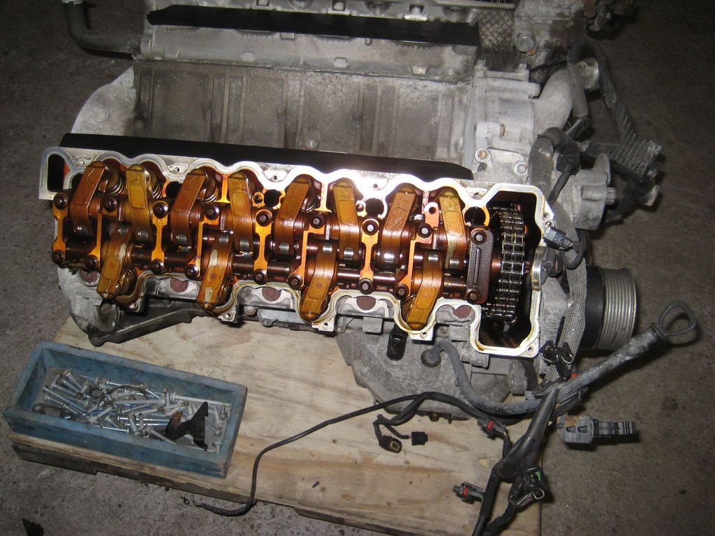

Little update from today:
greetings, Fabian
