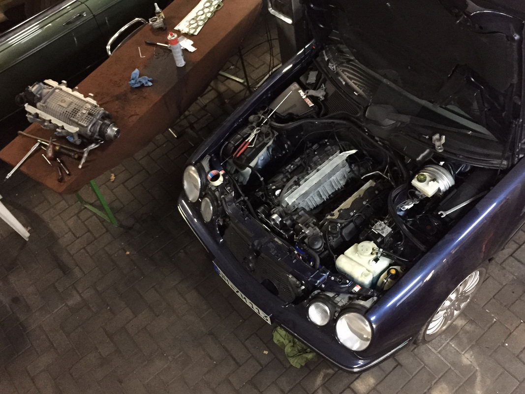

whoops, allready posted this vid i just see.
nevermind...
meanwhile i changed the bypass throotle body and installed some heatspacers ... thx² ZAYED for the heatspacers
greetings, Fabian

Old Jan 5, 2015 | 04:26 AM
  #425
kaype's Avatar
Joined: Apr 2013
Posts: 343
Likes: 48
W109 300SEL6.3, W123 280TE, W123 200T, W210 E55
Just a quick shot with my mobile
