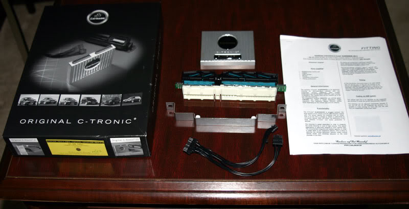

Carlsson C-Tronic
Installs in under 5 minutes, 100% plug n play. No glue, removing pins, or generally hacking up your car required.
