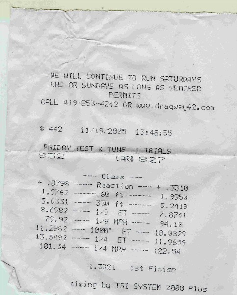

Let me first explain the experiment. I have a 2005 E55 that I absolutely loved. It had it all; speed, grace, and power. But like many of you, this just was not good enough. I was ready to test the hypothesis that this car can be improved.
After a long search of how I could make this car better, I was "steered" to Kleemann. Below, you will see two time slips. The first is of my car stock and the other is after K2 with LSD.
The stock run was at Norwalk National Raceway. This is a great and fast track. My 12.622 @ 114.49 was with traction control on and a, "stomp the gas" start. The temp. was about 58 degrees with no wind. Also, street tires with normal pressure were used.
I wanted to get back to Norwalk under the same conditions after my K2 conversion, but they were closed for the season. Because I did not wish to wait until next year, I was forced to take a trip to Dragway 42.
Unfortunately, this is not a good track (IMO). It is slow and I swear it goes uphill. The temp at the track was again in the mid-fifties but I raced into a head-wind of 20mph.
Again, traction control on, and "stomp the gas" was the technique. I ran a 12.2 @ 119.0. At Norwalk, with no wind I am sure I woud have run high 11's @ 120+.
I'm I happy? You bet!!!! I would do this again, because I think Kleeman has some great products.

Show me a stock E55 that can trap at 119. With DR or a good driver, this is now a mid 11sec car.

Thanks Rock for the update ... I think a comparison on the same track would be ideal. I am also a little surprised by the 60' times should be around .35 gain there alone ... and it does not seem the LSD has helped here at all.
If u take the 60' net of RT you were quicker before the upgrade. Pretty surprising and disappointing to me. Think you might be better off without TC. The TC seems to be quite agressive in pulling back the power, and now with more power it might pull back for longer.
What tyres (tires for u guys) are you running? PS2's or the Conti's?

Derek, you are right. It aint an 11.5 car until you do it. To be honest, I was more concerned with trap speed than ET. I thought this was the true way to measure for increased power. I saw plenty of cars at the track run mid to low 11s that trapped @ 114 or below. I would guess the difference is that they had sticky tires and they were not using traction control. This was only the third time I have run a car at a 1/4 mile track, so I am no pro.
Steve, I am not sure I have an answer for you regarding the LSD. Maybe, traction control needs to be off to show the true benefit from this mod.
Please, take these post for what they are worth. I am not here trying to sell you Kleemann products or trying to show you how great my car is. I only post these details to provide more accurate information on what these modifications actually do to performance. I'm just here to share information.

Rock you picked up almost 5 mph out the back door I think thats pretty good. Put it on a dyno jet and you should be around 460 to 480 rwhp.
I have been to norwalk so I know what you are talking about. The track has an incline after the traps to help cars slow down.
The thing is every one here automatically looks at the et which is only an indication of traction while the trap speed tells the real story. Rock keep working on the launch and your car will go faster, you should be able to 60ft in the 1.90's.

every 0.1 off your 60 foot is 0.2-0.3 off your ET. Get that 2.1 down to 1.8 and you'll be at 11.7@119.

Steve, I spoke to Cory (@Kleemann) he said that the 60ft. times likely didn't change because of the traction control. When you just mash the throttle, the tires won't hesitate to break loose, so the ESP is applying the brakes to both of your rear wheels, and it's most likely closing the throttle as well.
Let's just attribute my failure to see 11 second 1/4 mile times to me.

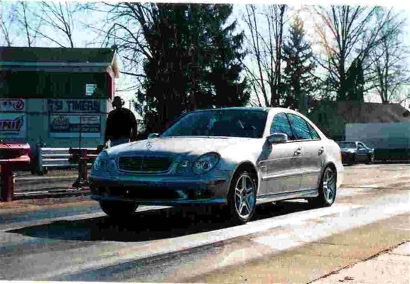

I wanted to update this thread after I had a chance to drive the K2 car for a while and allow the car to adapt to some of the new modifications. I visited the track yesterday, one more time before I change my stock tires to DR. The track conditions were similar to my pre-modification run. I ran stock tire pressure and had TC on. I made three runs and the car trapped @ 122 or 123 each time.
I am not sure why my trap speeds have increase an additional 3-4mph since I had the modifications completed. Does this car really need to "learn" its new modifications before making maximum HP? This car pulls so incredibly hard that my TC light is flashing even through 3rd gear.
Final thoughts................ I love the car, I love what Kleemann K2 does for the car and I would do it again in a heartbeat.
