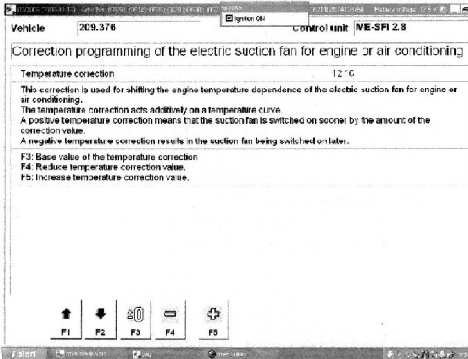

-10c cooling mod
Guy's there is no colder ,just drop in thermostat. I'm working on one as we write. The local MB dealership down here has a cool tech. We went thru the Star Diag today Step by Step and found the page . Here's a scan copy. Take care ___PTE___

I had my -10c mod done at the same shop that did my Renntech goodies and I was told that there was "lots of room left if we want to go cooler" when I picked up the car. Mine's an '04. So what's the deal with all the variance in adjustability??? Is it the software from year-to-year or maybe even the version of diagnostics that the techs are working with??
