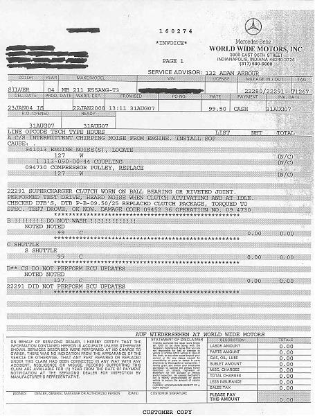

My stealer replaced my supercharger clutch after I complained twice. For the first complaint they replaced the belts, but the chirp lived on. I complained again and they replaced the supercharger clutch I think. I have the work order with me, I can fax it to you if you'd like.

can you guys post your work order for what they replaced?
sh*t .. looks like all they did for me was replace the pulley? .. i dont think my dealership replaced the clutch ... this is my work order from thursday:

A.) Cust States Super Charger Chirps When Driving (See TSB)
Cause: 11
094730 Compressor Pulley, Replace (N/C)
333 WLPC
1 113-090-00-44 Coupling (N/C)
41253 Noisy Bearing M Fail Replace Pulley --- DTC
Read Out No Codes Found in ME Trace and Locate Noise For Repair Replace
Super Charger Pulley Adjust Clearance .38mm As Per P-B-09.50/25, Date 01/31/2005.

Here you go man.

ohh cool .. same as mine i think? .. (see my post above)
i guess TSB P-B-09.50/25 is what people need to tell there dealership
