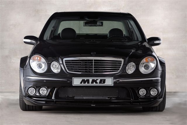

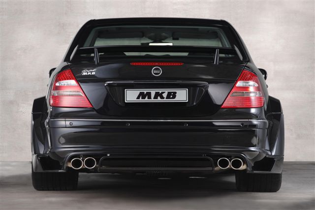

What I don't want...
It's just too much...
Attached Thumbnails Hypothetically, how much more rear fender space...-i446051391464b0e73a5071.jpg   Hypothetically, how much more rear fender space...-i1942210320464b0e729d917.jpg

Oh the pain,why did I click on those pics.
