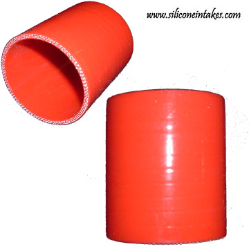

These Mushroom filters are $78.34 Cheaper, than HKS Mushroom filters look the same, Silicone couplers all sizes dirt cheap...Try this Site....Quality stuff I have (2) mushroom/foam filters/ few Silicone couplers etc...
http://www.siliconeintakes.com/index...dec919e1a8462e
Foam Style Air Filter - red, 3.5" inlet (THESE COME SUPPLIED W/C-CLAMP)
[AIR002018]
A universal, high-flowing sponge-style air filter for cold air intake installation on a round pipe.
These air filters have filter material and shape designed to flow as much air as possible while looking great. These can also be installed in areas with less depth than standard air filters.
PRICE: $14.99
3.0" Silicone Straight Coupler, Red, Blue, Black Price $6.99
HKS ripoff, looks exactly same but, List price: $110.00
Sale: $93.95 (THESE DO NOT COME W/C-CLAMP)
Silicone couplers...3.5 in / 89 mm ID x 3.0 in Length Price $13.00 Ea.
