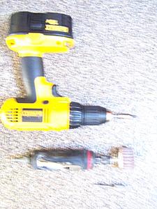

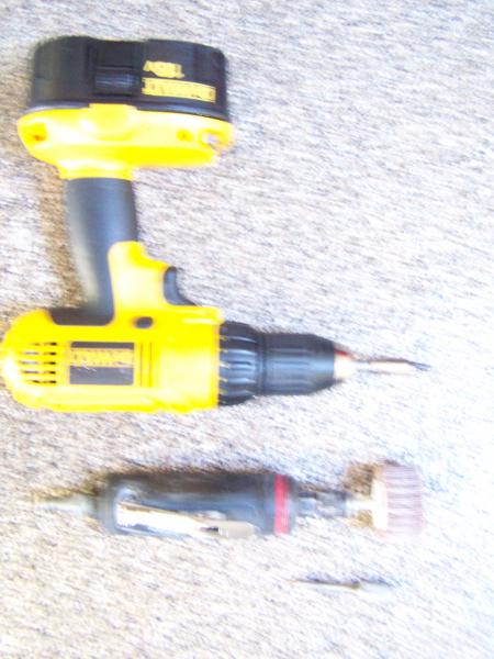

Here is a shot of the tools. Star wrench on the coordless to take the air box screws out (duh). Grinding bit and sanding bit to smooth out final fit. I also used some 80 grit hand sand paper to smooth rough edges. Last, used a water hose to wash out intake and then scrub dry with rag..
For the the best seal, take your rubber gasket out of the mouth of the 80mm Y pipe and reverse it. Then slide over the 82mm TB before putting the CF intake on..
