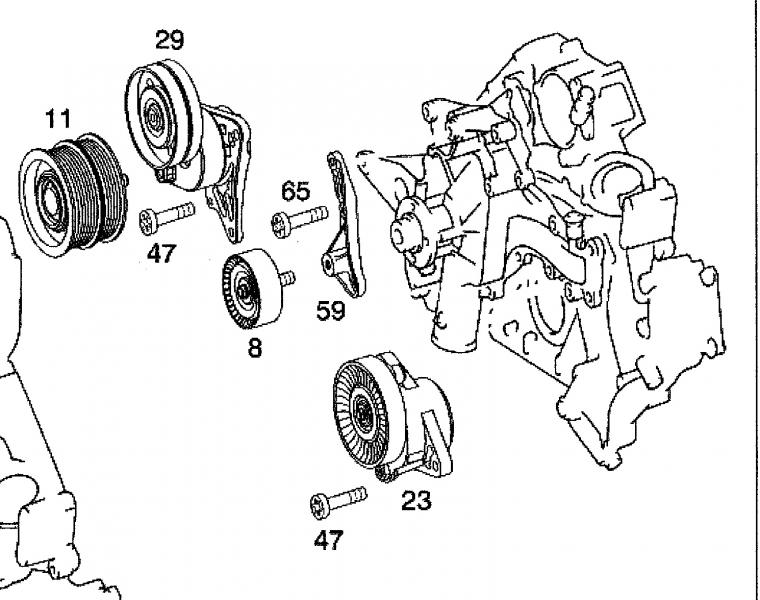

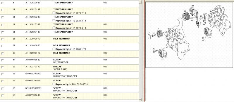

Which one? You can go to this website and for a penny look up all the OEM part numbers. http://epc.startekinfo.com/epc/

Originally Posted by Mrbig
part number i think it is A1132000170
11 = tightener pulley, part #1132020419 (for comparison shopping, parts.com $285.20)
29 = belt tightener, 1132000170 (197.80)
8 = tightener pulley, 1132020019 (48.30)
23 = belt tightener, 1122000970 (170.20)
V-belt, 1139970292 (44.85)

Thanks but they don't have the pulley i'm looking for. Though I do think I found what I am looking for.
I am looking for # 29 below. But not the entire assembly. Just the pulley. The stealership will try and sell you the whole thing for $200+ (mb part # 1132000070). I think I found the part # for the pulley only ( mb # 1122020119 ) for $51.00 at getmercedesparts.com.
