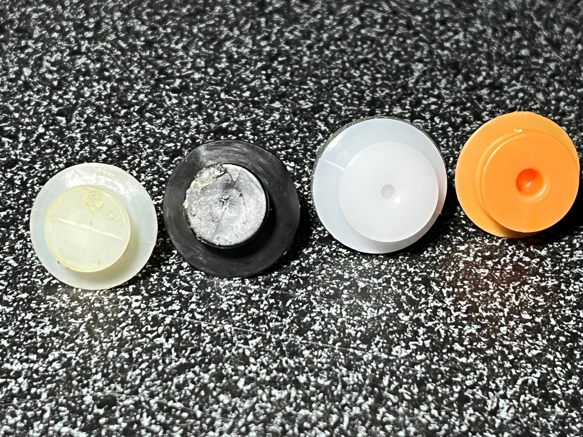

Here are some photos of the subtle differences in the trunk panel fasteners and the regular door panel fasteners for those that are interested. For what it's worth, I gave up on trying to find just the white or black clips and raided a few E-class cars at my local parts yard. I think I'll have enough to attach the panel securely after the weatherstripping replacement.
Trunk panel clips are the two clips on the LEFT in the photos. Photos 1 and 3 provide the critical differences in these parts. Trunk panel clips are shorter (probably irrelevant), but the heads (photo 3) are significantly smaller than door panel clips. It is for that reason that door panel clips will not work for the trunk panel without cutting down the diameter of the head. Even then, I'm not sure it would work well, however.
One last thing: The two clips for the trunk panel get a rubber washer (not shown in the photos) that is much thinner than the door panel fasteners.
