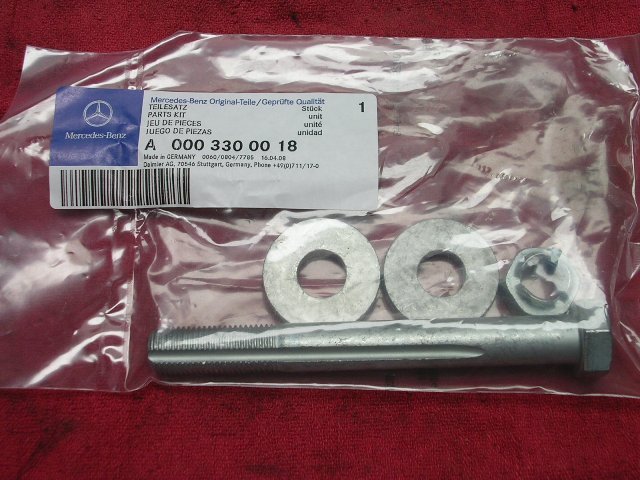

When I search the Part Number shown in the picture (Crash Bolt), I get returns on the regular bolt. I just wanted to make sure anyone who orders this makes sure the bolts they order are the adjustable version.. I cant imagine why it would share a part number...
A 000 330 00 18

So what is the KMAC kit for and what are the MB bolts for? I know both fix camber some how but do you need both?

so are these a adjustable camber bolts? and how much can you adjusted?

naive question, but do the bolts do the same adjustment as the kmac kit?

The bolts (often refered to as "Crash Bolts") allows a small adjustment. The KMAC provides a greater level of ajustability.
With KMAC, it is hard to get back to stock settings if you are slammed, but would probably be OK for what you are doing.
However: I would reccomend you do the KMAC now. It costs more, but you will go lower. (Yes you will)
You will do SDS, then you will be like: Wow, maybe a little lower, then you will buy links or ELM.. Then, you will be very glad you have the KMAC
