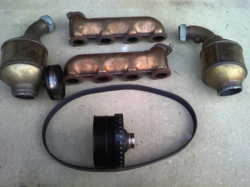

could I cut the curvy part and try to weld it on my new cats?

Old Jan 2, 2011 | 07:28 PM
shardul's Avatar
Former Vendor of MBWorld
iTrader: (1)
Joined: May 2008
Posts: 12,139
Likes: 295
From: Houston
2003 W211 E55, 2003 W220 S600
The od for the pipes that go into stock cats is not 3 inch. So you may have to flare the pipe. People put race cats on long tube. Kleemann headers come with down pipes so you can weld cats on them. I have rarely see people mate race cats without an aftermarket flange to shorty headers

O. How bout the whole moving the cat back more and using an 02 extender. (I dont know which one but I think I would use a 4 wire round extender) Would that work?
