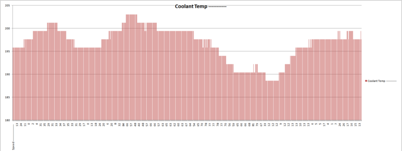

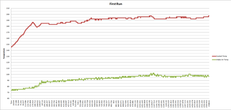

Random question for any of you Houstonians: I did some pulls with my OBD2 reader and laptop today [obdscan apex], and had some questions about IAT's and Coolant Temps.
Ambient is 81*: Did 3 pulls from 40 to 100, IAT's maxed out around 140*F and within 10 seconds had dropped to around 105* each time, which is where they stayed cruising. The only thing that took them below 105* for the entirety of my drive was sitting idling at a stoplight.
My coolant on the other hand...didn't drop below 180* even after sustained highway driving, and jumped to just above 200*F during the pulls. Is this normal operating temperature for coolant?

So my IAT temps are money, couldn't be happier with the temps as ambient was 78*F-81*F for the entirety of my drive.
However, regardless of whether I'm doing pulls, sitting in traffic, or cruising at 60mph, my coolant is almost always north of 190*F.
Is there a way to further diagnose what the culprit is?

Our cars are supposed to sit at 190-200 for coolant
I had a 180d thermostat and the car threw codes for engine coolant to cold in the winter months.
your coolant never dropped below 180 because it has a 190d thermostat on her

The OE thermostat opens at ~ 87° Celsius/189° Fahrenheit. Looks pretty normal.
