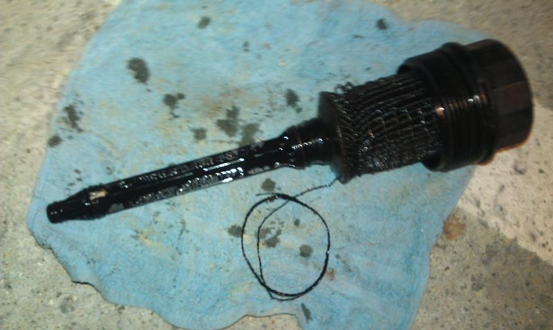

This goes in hand with the thread recently regarding oil changes. Use a genuwine mercedes benz oil filter.
This was the first time I used an after market filter in the car and it will be the last! The shop had an option of two filters and I took the more exspensive one because they said it was better quality, I think it was Bosch.............................. I never had this problem in my other mercs.
WTF after 6 months (3000miles) it looks like this. Falling apart and collapsing......
It wasnt scheduled for an oil change but I needed to drain the oil to work on the car for another task.

Wow....crazy. That looks like an OEM filter though...at least I haven't seen a non oem filter with that spiral around it ( I haven't seen a bosch one though so I could be wrong ).

It almost looks like the filter was crushed from being too long for the filter housing?

Or from not being inserted all the way in, which can be really hard on non oem filters. I used to run non oem filters until my car had lifter noises that went away with the oem filter....crazy stuff I tell ya.

Either the filter was incorrect (too long) or it wasn't put far enough under the cap... And yes, Mann is an OEM supplier.

I agree the first horizontal line scribed on the filter has to be oriented just under the skirt of the housing which means you have to twist the filter and use a little effort as you push it in, otherwise a crushed filter will result.

dont think the filter was turned all the way to cover the white line, and when the housing was tightened down, it crushed the filter???

Ok guys I have to admit that I was blaming the oil filter at first and I can do the oil filter change with my eyes closed and one hand .......
I am sure I checked the fitment when I did it and swear I pushed and twisted it on like I always do.........Hey a mechanic always blames his tools and never himself.
Yes to confirm 100% DO NOT USE PAPER FILTERS, I use only the fleece filters.........
Thanks for the usefull info regarding O.E. being made by MANN, Mercedes charge £15+ for their filter...

I typically use either Mann, or the OEM with AMG embossed on it. This picture is reallly weird, looks like the filter was collapsing on itself.
thats what I thought and also the string holding it together is falling apart hopefully nothing is left in the engine.

That would be really bad if a piece of string got caught in a oil passage.

Was the picture you posted in your OP showing the broken down black falling apart filter a picture of a "paper filter"?
You said the filter was put on at the dealer and might have been a Bosch, just curious if you remember whether it was paper or fleece material?
