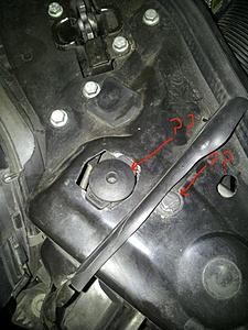

Here another noob question: how the hell do you figure out how to remove clips and other **** on various parts of the car without breaking them first? See picture for example.
After you take all the bolts off the top plate (of course) the one on the left hand side of your picture simply pulls straight up along with the plate it's attached to. It has a rectangular piece underneath that fits into a bracket but I don't remember anything holding it in. The one on the right requires some upward pressure to pop loose and I used a wide screwdriver on either side and didn't have any problems.

Well I tried sneaking a flathead under the one on the right and a piece of it immediately snapped and broke off. aarggggg
Did you unbolt all the other bolts on the top plate first? That whole assembly lifts up once the bolts are removed.

Ok, I just got home and took a look at it...
There are three (3) bolts on each side of the plate that need to be removed.
Two (2) torx screws and one (1) bolt in the center that attach to the hood release assembly that also need to be removed and then the whole top plate will lift straight up. You'll need to use the screwdriver to pry from underneath the plate where the little piece that broke on you is. Those pieces remain attached to the plate itself when removed.
Be careful of the hood release cable when you go to put everything back together as it is routed under that plate and can become pinched.
