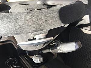

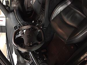

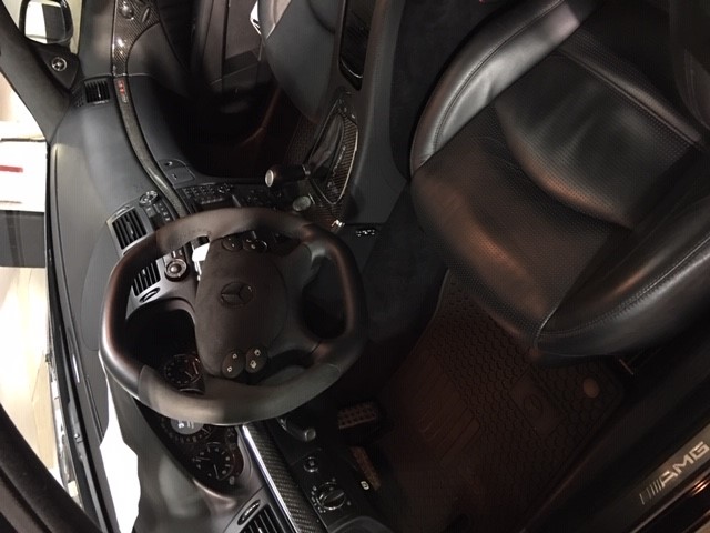

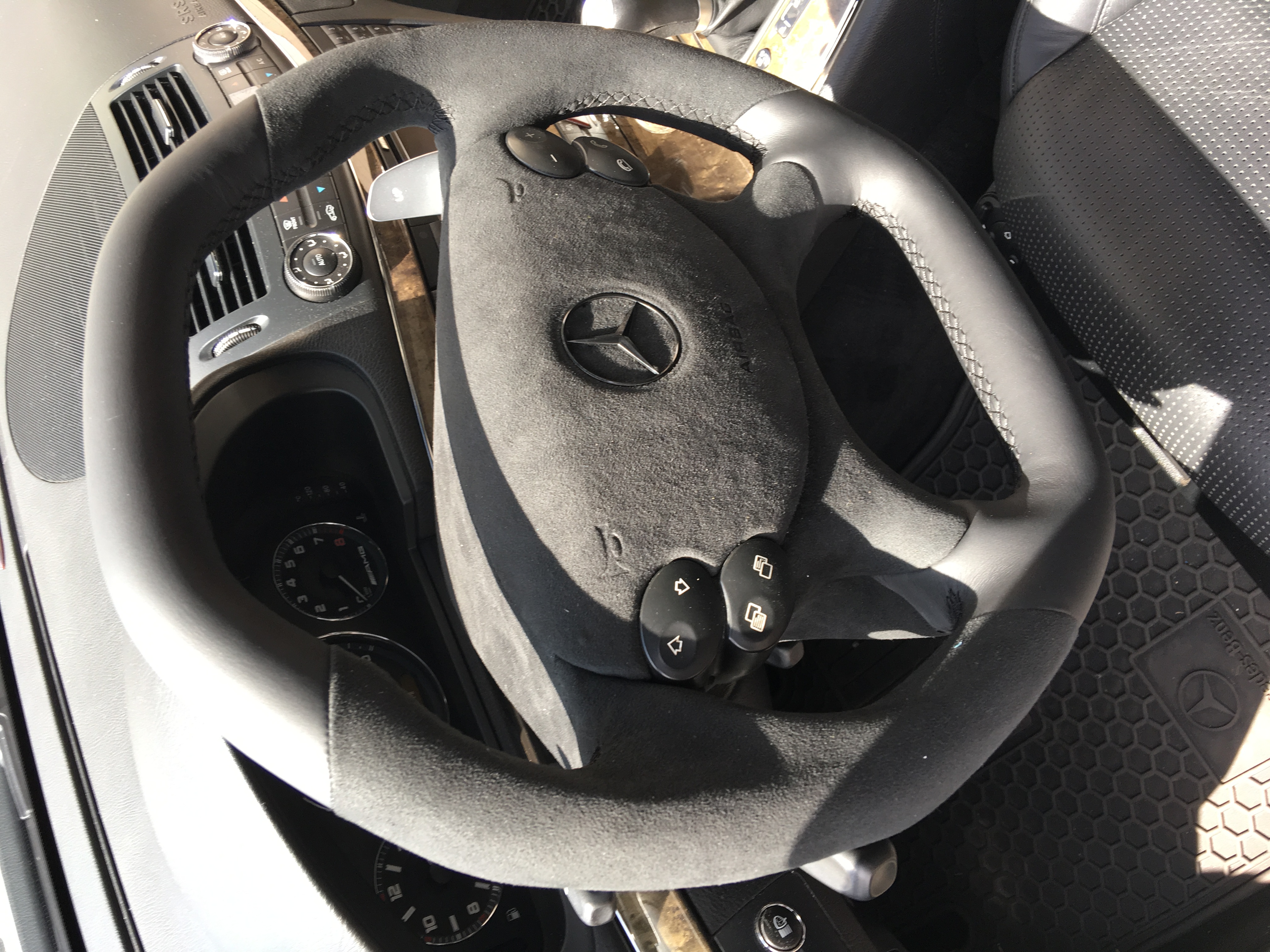

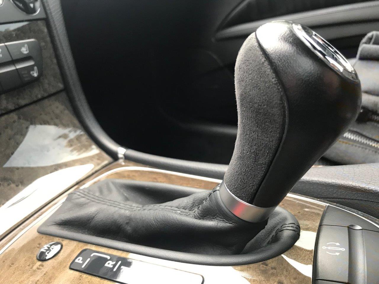

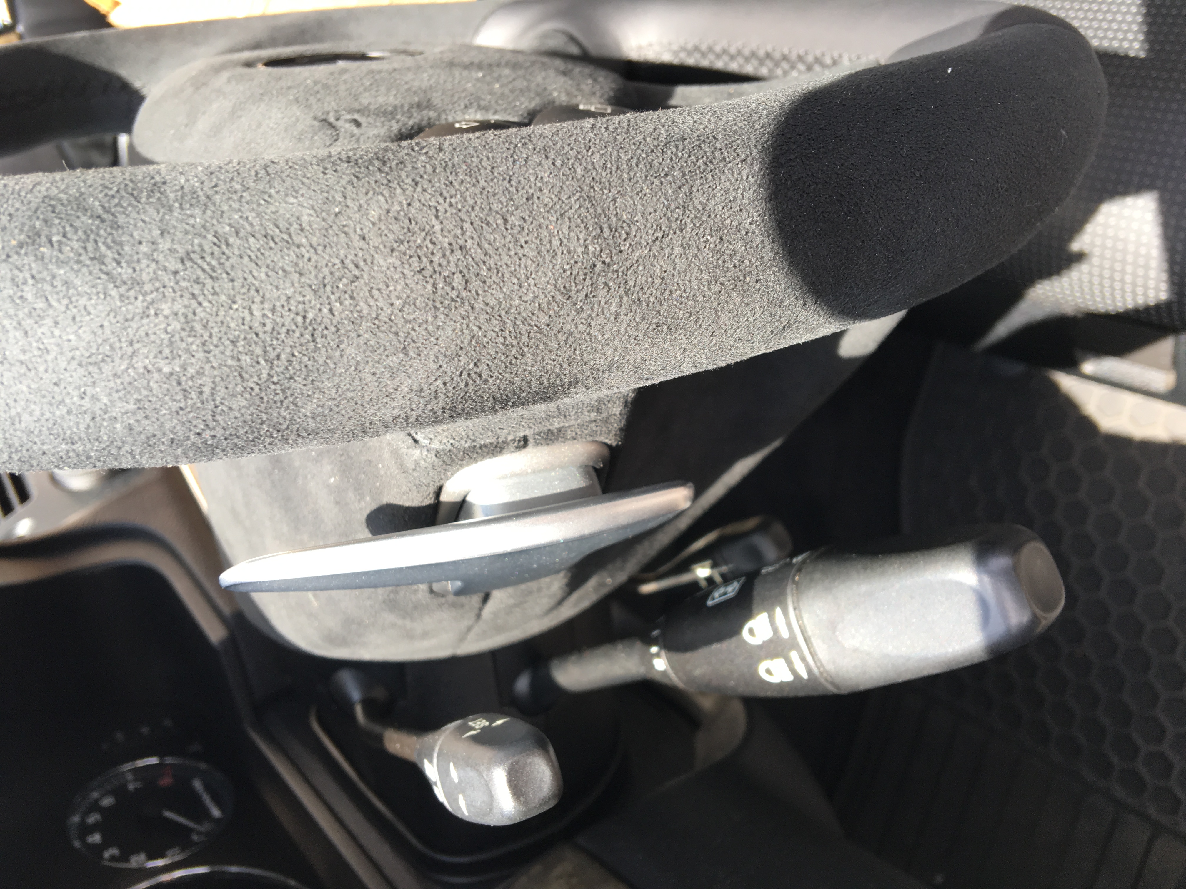

Why do most people shy away from Alcantara covered steering wheels? Is it because, they think that the material will not last? Or is it because after a while the material gets all nasty and ratty?
Maybe, I can convince you. Alcantara is a durable material, and will last for a long time. The reason, why you see some C63 and E63 with the P030 or P031 package looking all nasty, is because the owner neglected to take care of it.
Or they were just too dam lazy either way. The key to keeping Alcantara looking nice, is to keep your hands clean. The natural oils in your hands will transfer over the Alcantara material, and over time will become nasty, if not cleaned.
Sonnax makes a Alcantara and Upholstery Cleaner, that I use specifically for my wheel. Simply apply the cleaner onto a soft bristle brush, and with lite pressure gentle scrub the wheel. Also works great on the shift knob as well.
Keep in mind that you don't want to saturate the Alcantara, it should be slightly damp not soaking wet. Gently scrubbing the material will raise the dirt to the surface, where you would use a microfiber cloth to wipe the cleaner and the dirt away.
Sometimes if you scrub to hard, the Alcantara material will develop what, I call lint *****. Simply take a 2500-3000 grit piece a sand paper and rub it away, apply only very light pressure. The lint ***** will be removed.
Then let the steering wheel dry naturally. The key to keeping it looking excellent, is to have a small bottle of hand sanitizer on hand, or in your glove box or center console, to apply to your hands before you ever touch the steering wheel.
Or even better wash your hands before you ever get into your car. My steering wheel, still looks new from the day it was installed.
Attached Thumbnails Newest steering wheel in W211 ?-my-e63-11.jpg   Newest steering wheel in W211 ?-0aa68905_4ea2_4bdb_bc5b_bc1a64bc703f_4b426974cfda612f7862cc2d5d9e7c2ab16c4c31.jpg   Newest steering wheel in W211 ?-img_3808.jpg   Newest steering wheel in W211 ?-img_3810.jpg

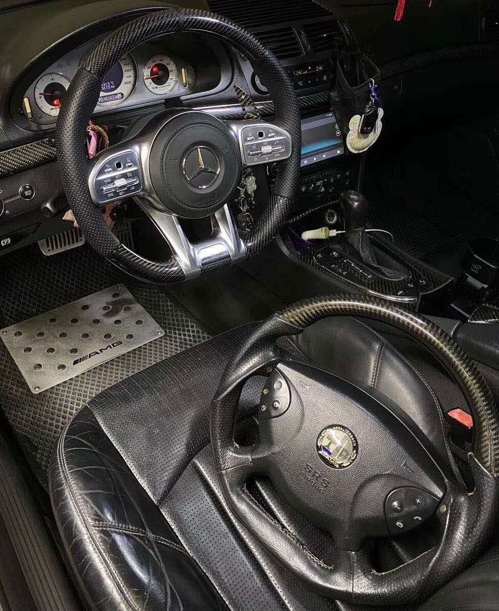

I have make this conversion in many w211,w219,r230,r171,w164 with 2018 AMG steering wheel or also 2013 AMG steering wheel
I can send steering wheel worldwide ready for installation
more info in pm or email or WhatsApp app

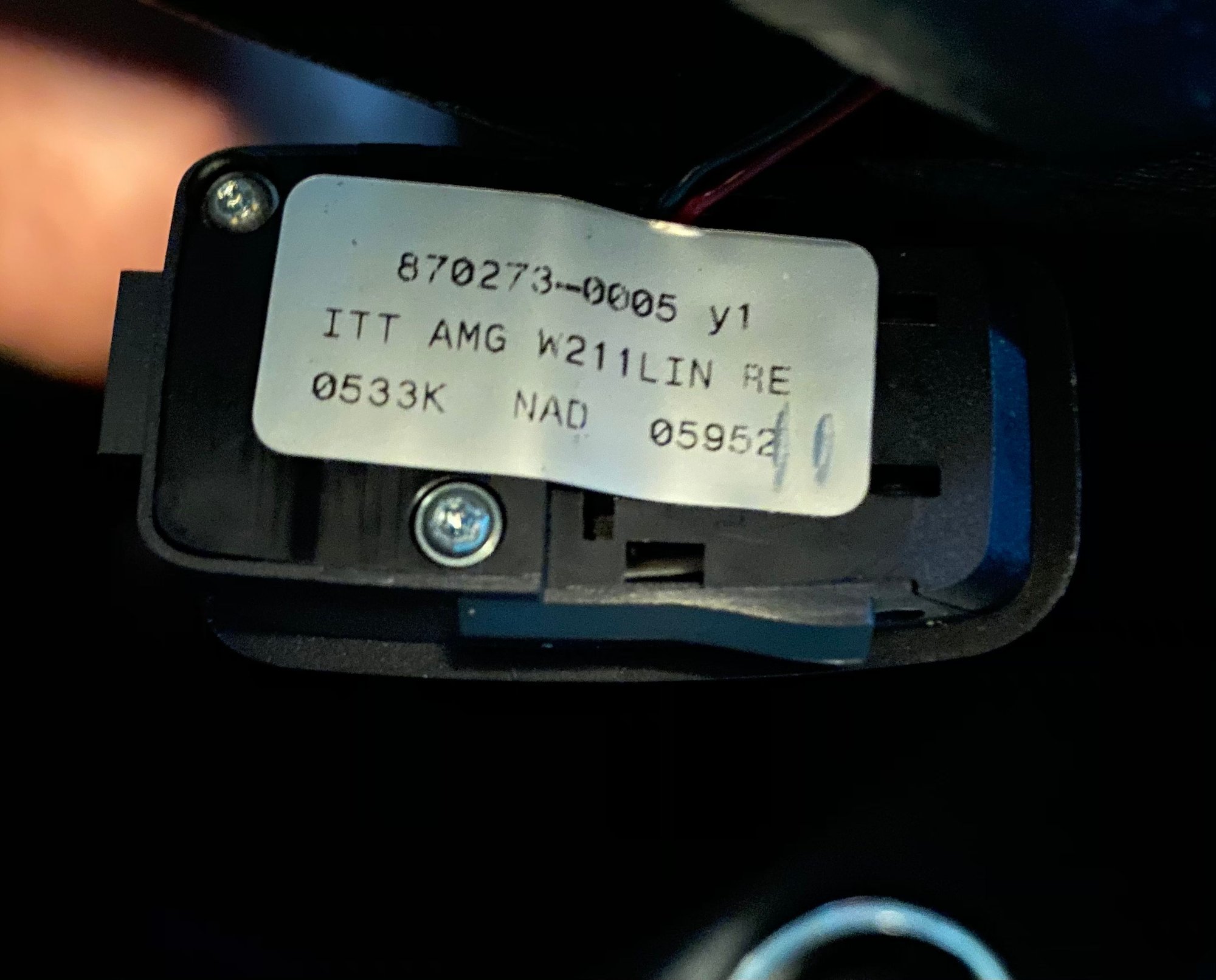

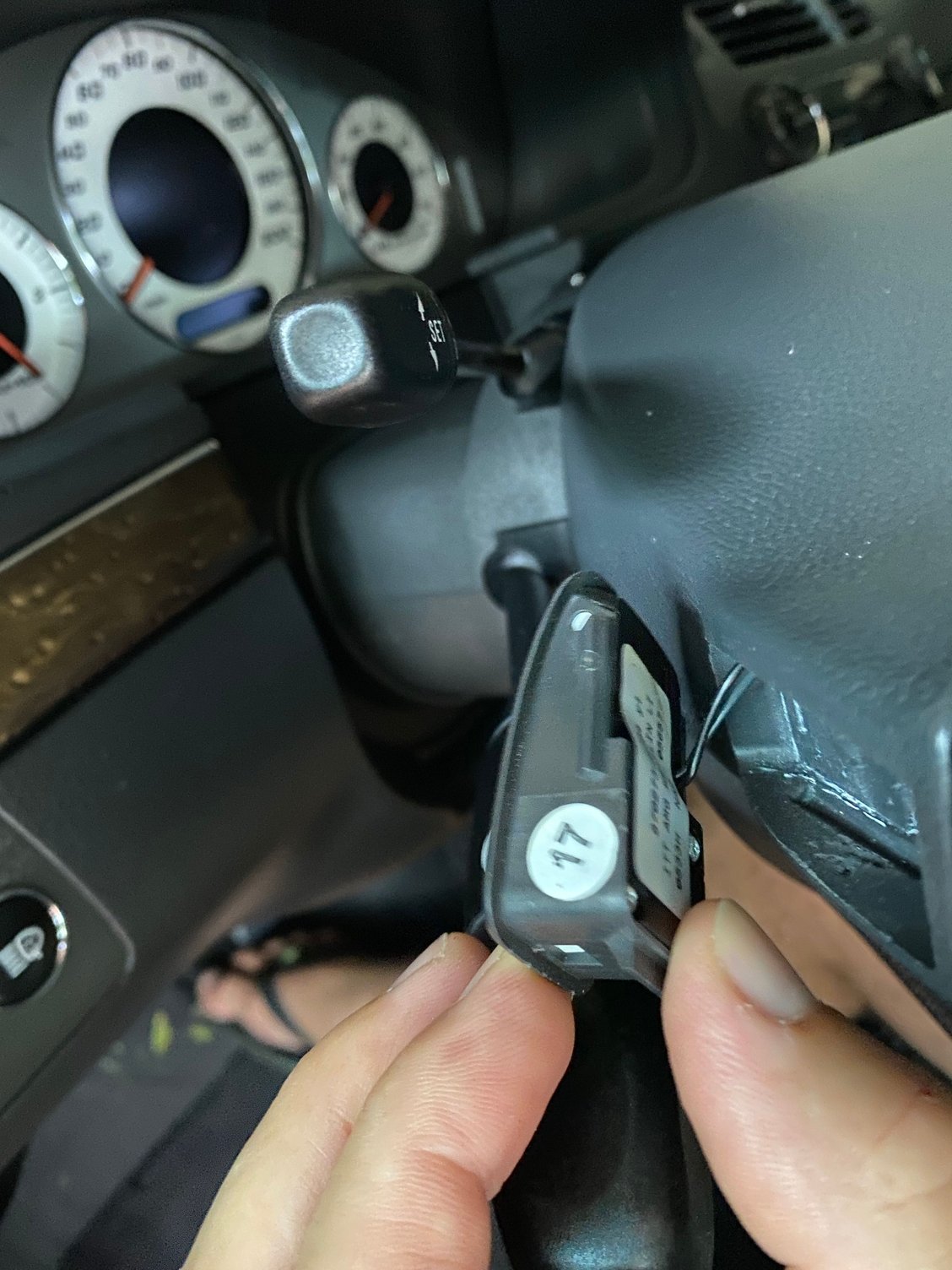

Open shifter buttons
Anyone know how to open the shifter buttons? I ordered a new wheel from ledermanz and he’s asking me open open the buttons for photos and details so he can add paddle shifters. Here’s what my buttons look like. 2006 E55

They are probably wondering if you have digital or analog Shift buttons. You are car has digital shift buttons which you can tell by the part number on the Button.

When they asked me to do pics I simply removed the airbag and did several pics of wheel internals. That was enough.

Originally Posted by augu
does all buttom on steeimg wheel work?
Yes, they are mapped to the original functions...
even the cc controls?
nice work! You made adapter or steering wheel just rewired modded components?
Cheers, No, the CC is still on the stick. I custom rewired the new controls to the stock control module including the LED lighting. New resistor values were used to blend in the brightness with the existing interior lighting. all was a very tight fit but works OK. I also used the old dicast padel shifters with the longer levers. A shroud cover section was also made and wrapped to cover the column. The indicator arm was bent back a bit to miss the shift padells.
Sweet! Looks much newer with that one. Was thinking about doing the same for my 221 .
