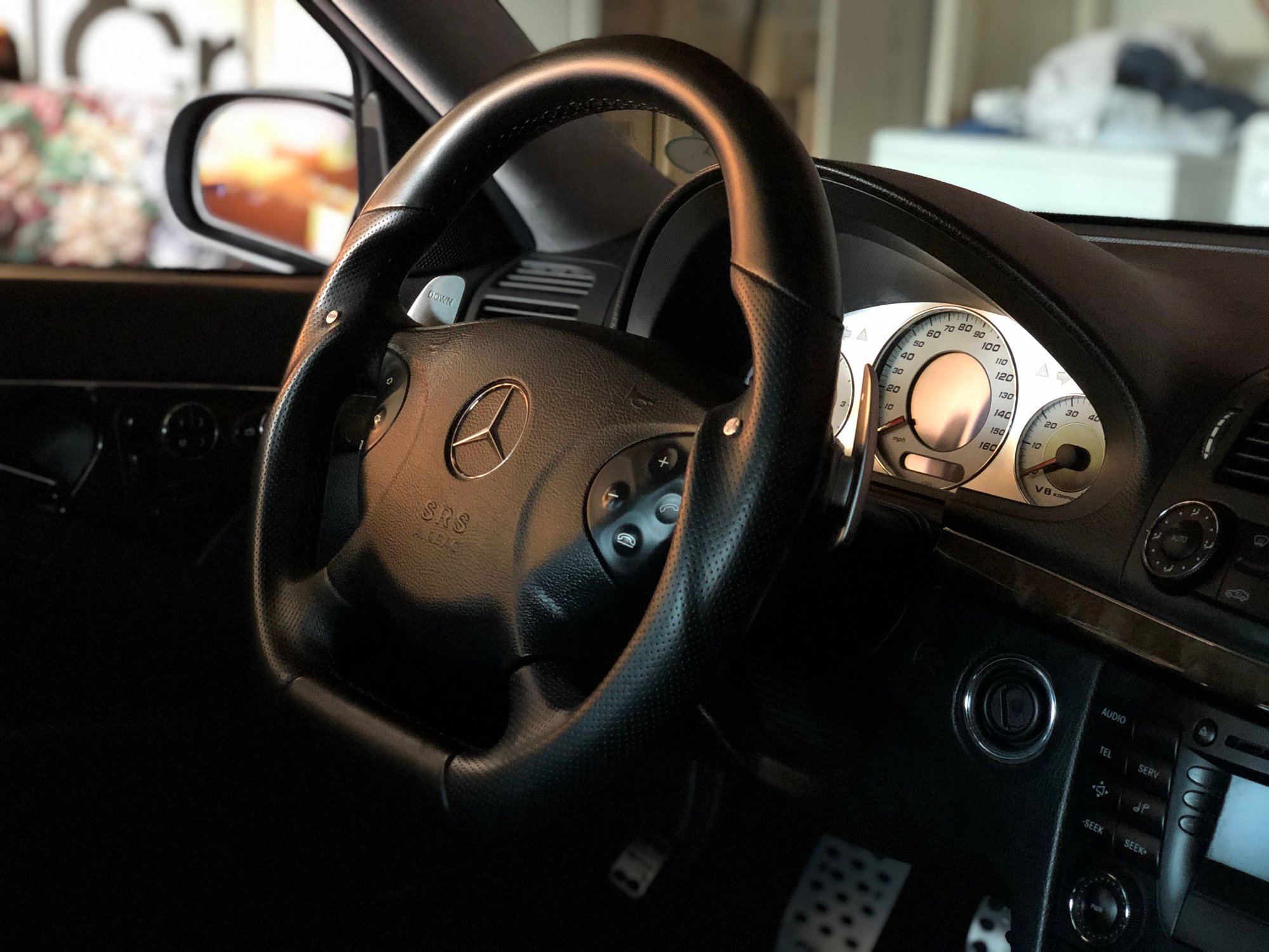

The steering wheel that I bought back in 2013/2014 for my E55 was from DCT. It was the DTM Style wheel with the flat bottom. Then I replaced the buttons in the back of the original wheel and installed some excellent paddle shifters. The steering wheel definitely changes the look and feel of the car drastically. Here are some current pictures for reference:
what all needed to be done to fit the paddles over the buttons? Love the wheel BTW.

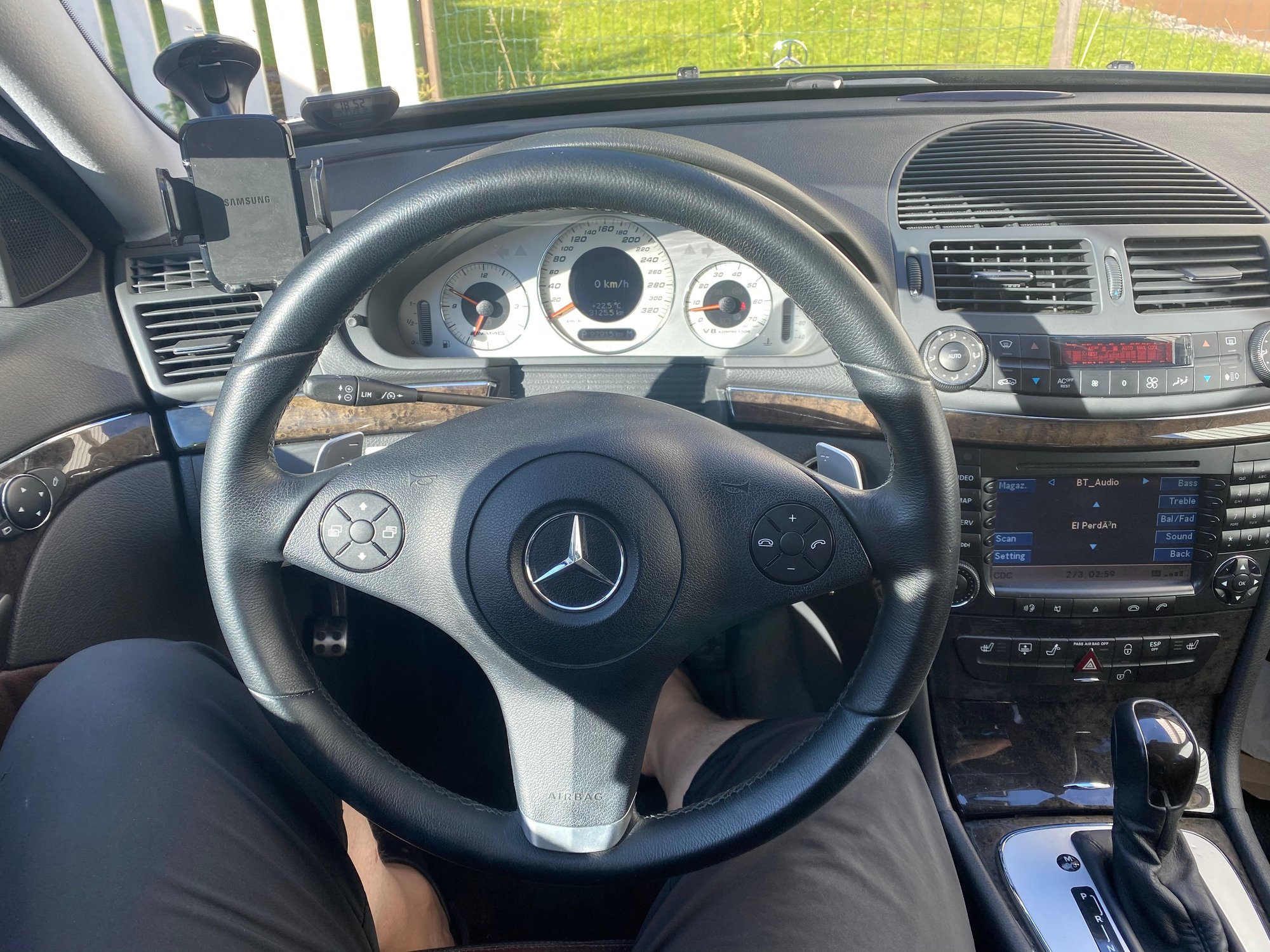

Here is my current OEM steering wheel lol:

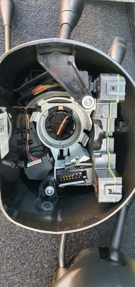

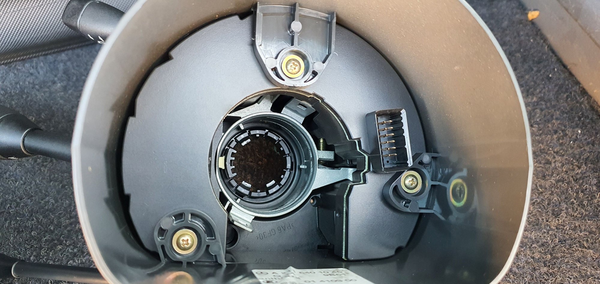

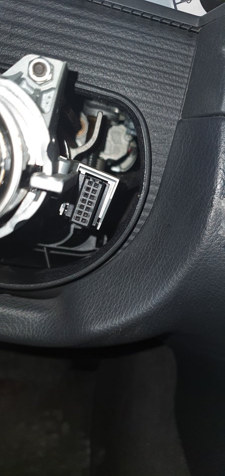

Exclamation Need Help Regarding Steering Wheel Upgrade w211 400 cdi 2003 !
Hi Guys
I have w211 400cdi 2003 year, and i want to upgrade from the stock steering wheel to the sport packed steering wheel with paddle shifters.
I have bought second hand steering wheel with paddle shifters also steering wheel column and the connector.
I need help for connecting pins from the old one to the new one.
For more info detailed pictures in attach.
This the steering column the old one.
Old connector of the steering column electronics .
New steering column that need to be connected.
