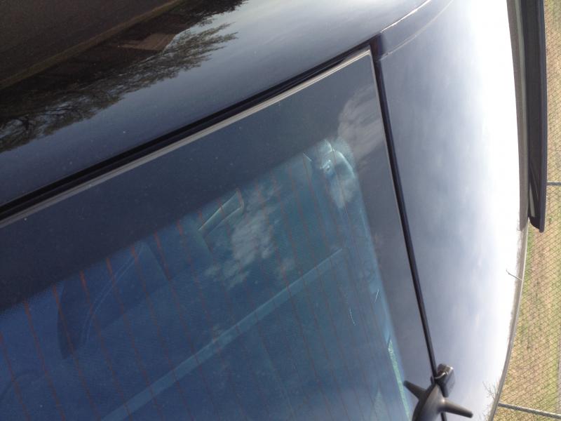

I did the same thing, except i mounted it on the roof in front of the old one. I just ran the wire around the window channel.
