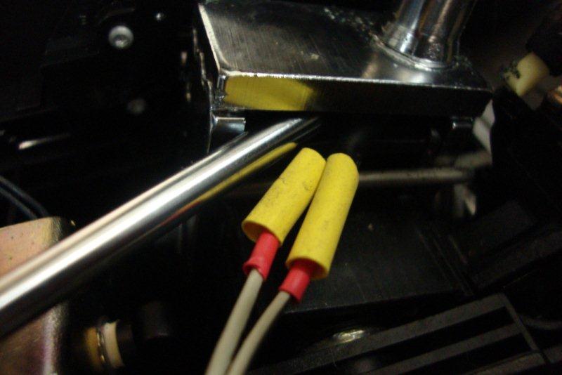

Yep.... Fixed !! As expected it was the tiny 2 wires from the shifter stick that was broken. I pulled the short end of the wires back through the hole and soldered a new flexible wire onto it. I used a wire from a pair of small headphones. These wires are very soft and perfect for this purpose.
Best regards, Michael

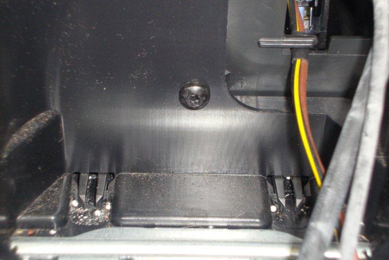

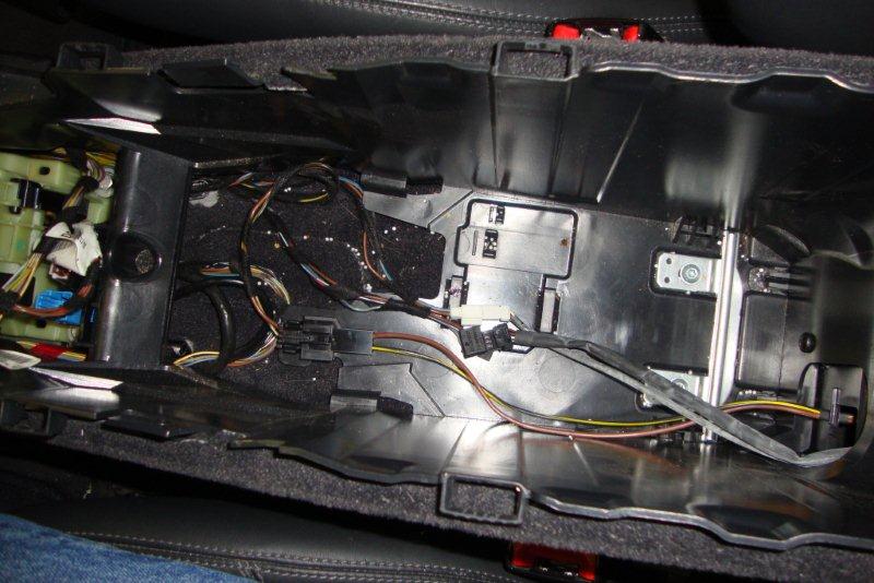

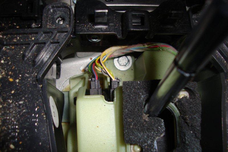

Hey I found the problem for the keyless go button on the shifter not working. You can take the knob off and check the switch with a meter. Found ours to be fine and saw a post about the wires at the bottom of the shift lever broken. That was it on ours. You can look down the center with a flashlight if you pop off the wood around the shifter and get it out of the way. The wires come out of the center of the shift lever (its hollow) and make a sharp turn. Shifting it back and forth eventually breaks them off. (See Pic9) It was kind of a ***** to fix because the center console had to come out and the wires are not very long to get in to solder back together. Anyway here some pics. The posts that I found to help me take out the center console didn’t show this screw that holds the back ash tray or vent that's on the back for the back seat passengers. Its big and beefy. Once you take out the front 2 screws for the box the back has metal clips that pop out. See pics for the metal clips I'm talking about. Then you can get that screw from inside back (pic5) to release the vent off the back. I don’t have photoshop so I can’t put the arrows on my pics like some high tech guys on here but you’ll see it. The yellowish plastic cover has to be pried off at the bottom once you remove the screws that hold down the shift mechanism. I used a decent scraper(pic8) and put some old magazines down to protect the wires around it while kinda prying the glue. It came off pretty easy really. Once you have it off you have enough room to work on the wires. Last pic shows wires back together with some shrink tubing on to protect them. Hope they last a while. Anyway hope this helps.
