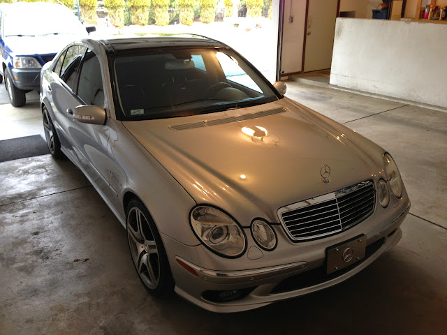

This post will serve two purposes, first an introduction and second a buying experience.

That's when I signed up here and started looking for a replacement. I took my time and did a ton of research on this and other forums. This past winter I started seriously looking and found a few relatively local cars. The first car I drove was a 2005 early example with the bi fold console 58K miles. The car was loose, needed ball joints alignment and so on. I lowballed but never received a response back from the dealer. I think they wanted 28K and I offered 23. The second car I found was a late 2005 with 93k. I admit I was scared of the mileage but wanted to drive it and compare with the other one I drove. It was listed for 22k. I drove it and most everything checked out. I did my own "ppi" on the car and noticed a few faults but nothing I couldn't handle on my own. Long story short after the back and forth I picked it up for 16k. The entire process took a few months over the winter and I had in the garage April 1. I knew going in what to expect, again due to my research and the copious amounts of great information here.

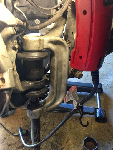

Car was running great and the weather turned for the better, windows down cruising season. I noticed a high pitched squeak coming from the driver’s side. It didn't go away and seemed to get worse. After about 2 weeks it turned into the seedy motel squeaky bed noise as seen in this video.
https://mbworld.org/forums/w211-amg/...oints-e63.html
Again looking toward AutohouseAZ I bought the upper and lower ball joints part cost was about 100.00.
I went to autozone and rented the Ball joint press and proceeded to replace both the upper and lower on the driver’s side.
Dealer quoted me about 2500 over the phone. They wanted to replace the entire front suspension lol. Total rip off.
My dog was giving me a hand here lol.
Everything went well and with air tools the repair wasn't that bad. I split this repair over two days and about 4-5 hours total. After completing this repair I needed to get an alignment done. My good friend works at the dealer as a service adviser for VW (the dealership is VW, Volvo, Mercedes) and was able to get a good deal on the alignment. 250 total. While it was in the shop I had them do a trans drain and fill along with the replacing the leaky tcu plug and filter. During the alignment they needed to replace the lower ball joint also on the passenger side. The total bill was 750. Without my buddy it would have been around 1500.
