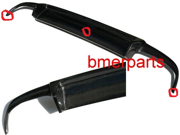

I just installed the same style for my E63 and it fits well. It took me about an hour, 3 screws and some double sided tape. I will snap a quick pic and post it up tonight after work. TC

nice! can you take a pic of where you screwed the screws in?

Here is a quick cell phone pic, I put a screw in each on the red circled spots on the 2nd pic.

Ok so you just drilled right thru the diffuser, I would think it would crack around the screw.

No cracking at all, I used self tapping screws and they went through pretty cleanly. TC
