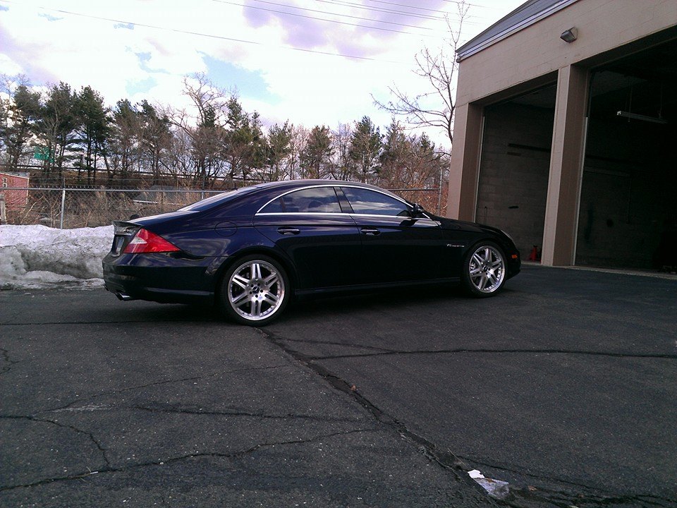

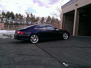

nm i fixed it, the seal they gave me was incorrect, had a metal ring with slots on it, thought maybe it was a re design and was rubbing against the inside and preventing the hub to seat to the end. put new mb seal in, re installed, wheel spins MUCH better now, no more noise. put summer wheels on as well. 18s to 20s makes big difference in driving...
