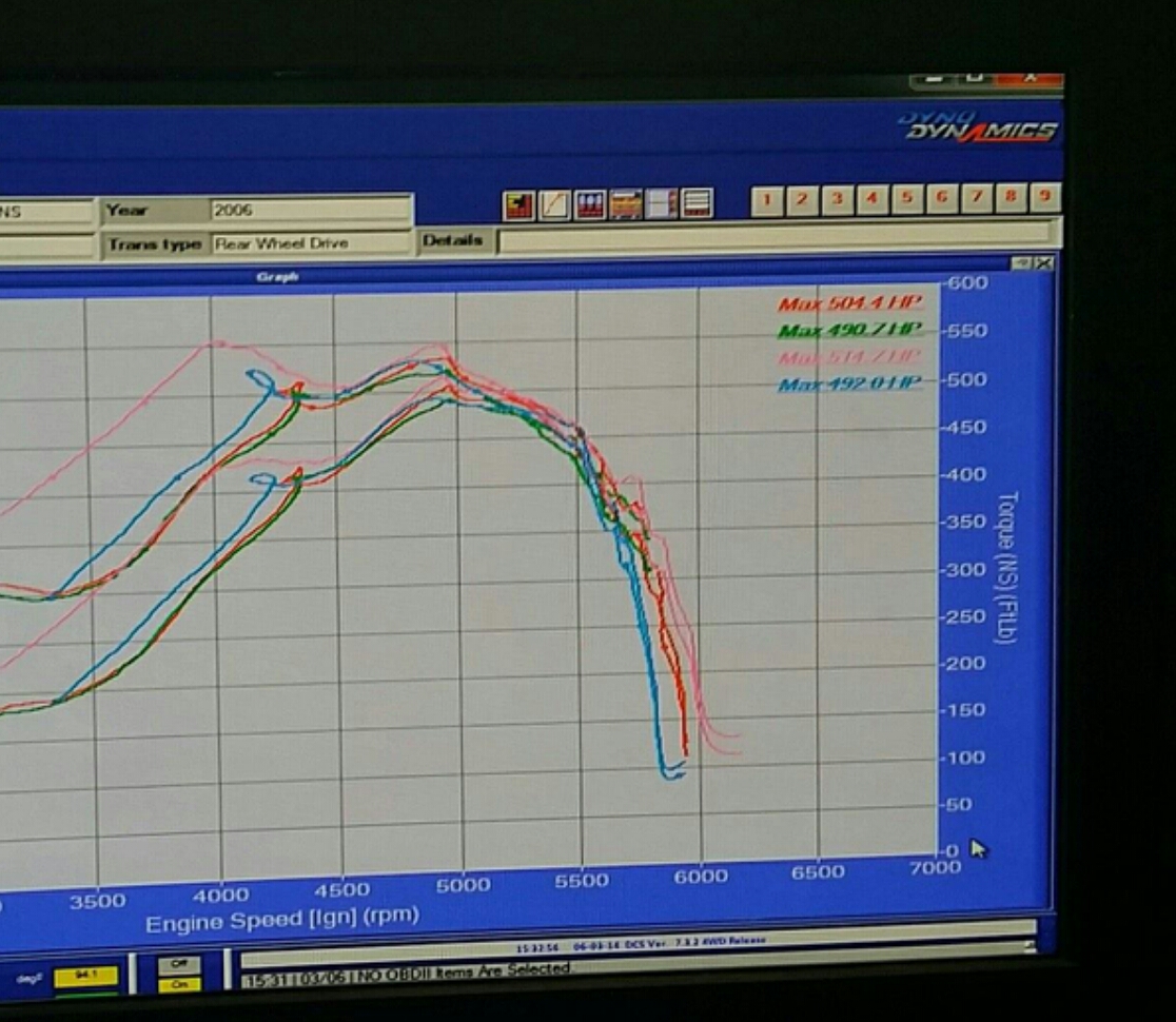

This is what the pull looks like.
Attached Thumbnails another twin turbo e55 amg is born at BIP-2014-07-09-19.33.00.jpg

How much boost? That chart is not pretty, no offense

That curve looks like it's getting ready to take right off.

I do not remember or maybe it has never been posted but what exhaust manifolds are you using? Have you checked back pressure at the turbo. I have seen drop offs like that with really high exhaust back pressure and on restricted engines. It is like hitting a wall.

I would think that you are hitting a wall on the air flow in the manifolds. If so you would see exhaust pressure spike in the manifold not increase in a linear fashion. If you could get a probe in there to check it would be worth while.
Air goes supersonic when you hit the wall. On the rally car I tune it has a restrictor in the intake in front of the turbo and it goes into full vacuum within a 100rpm. It is not gradual at all. I also had similar dyno graphs on my personal car years ago with a supercharger and the stock exhaust. It would have a 10psi spike in the exhaust system. I had a probe in the egr port. Actually that is not a bad idea for rigging up a sensor. You could probably either go to egr or the secondary air injection ports in the head.
Neither would break up though. IT would just flatten out and power would drop off like a stone.

It is 13lb springs, and we are seeing high 12's at taper.

Strap the car down tighter. Looks like you are spinning.

Looks like your dyno graph would make for a nice roller coaster ride! lol What happens to the AFR when the hp plummets? What happens to the boost?

Been following along. Lots of great reading. Which gear are you using? How about MPH at the cut-off?
Looks like you're near 90%... That last 10% is a PITA.

Good news is it looks like it will make really good power once it's able to pull to redline. Don't give up! Being a pioneer takes alot of effort, then everybody will copy you when it's done lol

Car is not slipping on the rollers.

You might try dropping the boost a few pounds and inching your way back up like suggested. See if it pulls straight through at lower boost levels.
It is strapped down pretty tight. On one of the runs the car snapped one of the straps on the hit and it almost got ugly. It's not pretty to see that when it is your own sled on there
Thanks so much for all the feedback guys, really appreciate it.
