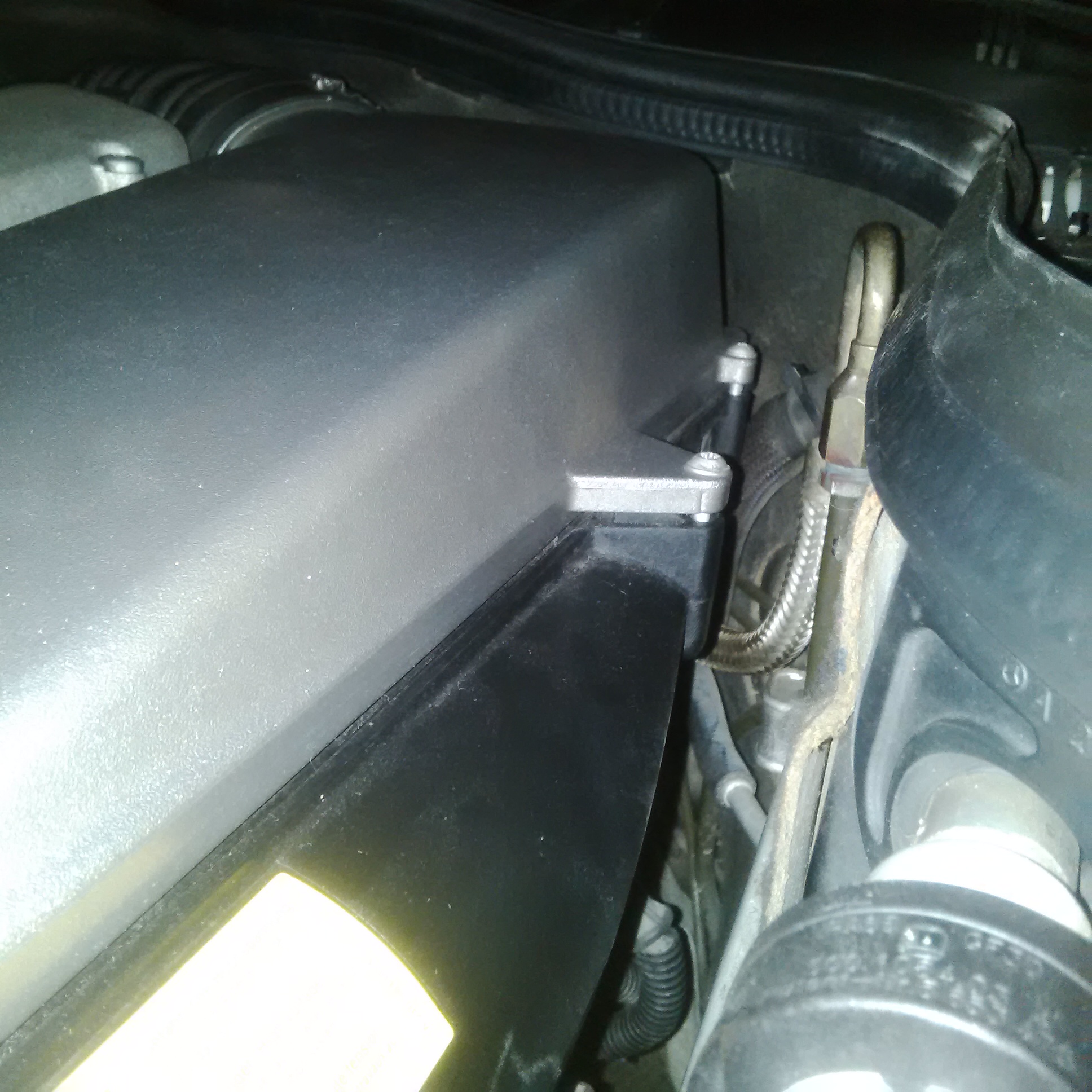

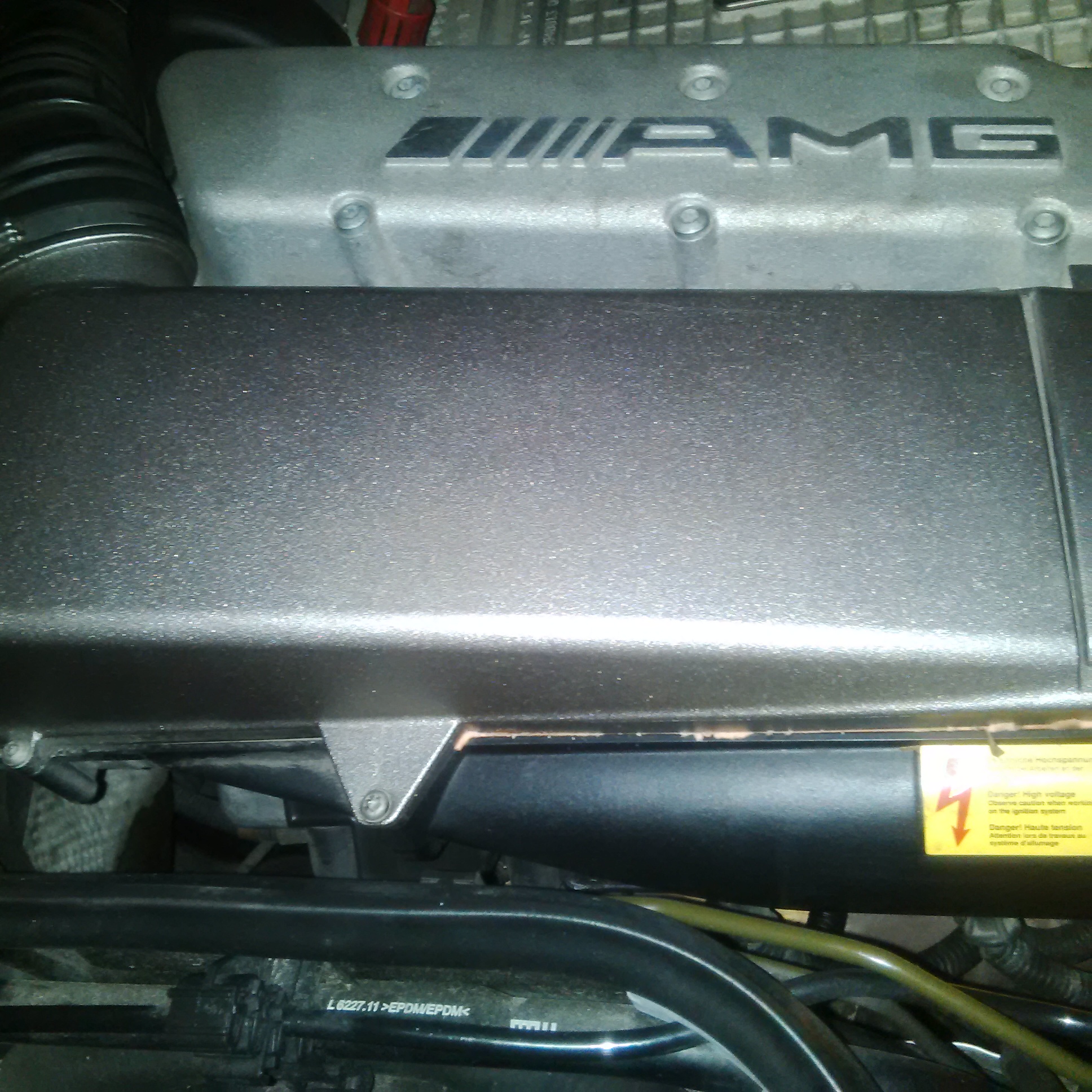

No oil drips. No burning smells. Upon inspection everything seems to be connected properly except for the screws on the plastic engine cover thats connected to the superchargers air intake. The one on the drivers side are badly screwed in and you can hear air blowing on that side, cant feel it just hear it. Also on the passenger side there seems to be a pink insulation material there and the drivers side none.

Pics?
Old Oct 13, 2014 | 07:45 PM
A.M.'s Avatar
Joined: Sep 2014
Posts: 179
2005 E55 AMG
pics.
Passenger side. Sealed, tight screws.
and driver side. No seal, loose.
Attached Thumbnails Valve cover Gasket changed...Now check engine.-img_20141013_193219.jpg   Valve cover Gasket changed...Now check engine.-img_20141013_193247.jpg

Those are your air filter lids. Shouldn't really be causing your issue, but I'd tighten it down correctly anyways.

That's not good. Did you get an aftermarket cheapo brand air filter? Are they set into the air cleaner correctly? Def should NOT be like that GAP. Mine are shut tight.
