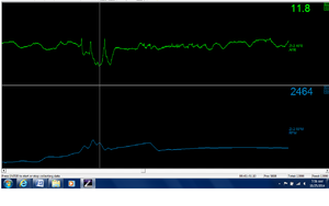

77mm this is a quick part throttle stab which feels like wot with fixed pulley notice that afr drops real nice.

That looks nice!

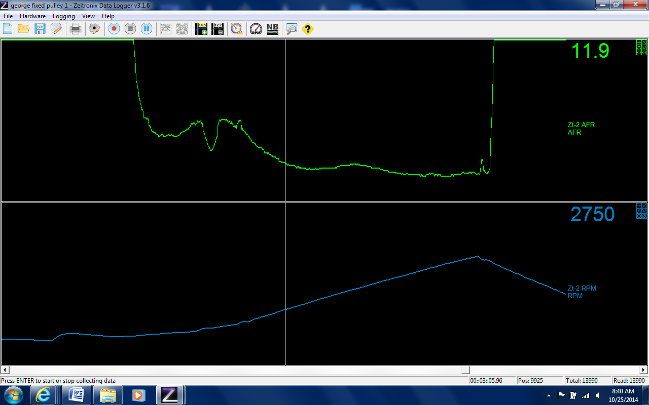

Load vs tp has totally changed with the fixed pulley. this is a wot blast in 3rd gear I rolled into it afr came in nice that was the first tune for his car no adjustments it richens up too due to high act.

I like what I am seeing on your little clipped graph, however 53 degree rise in a 3rd gear pull means I will be looking for a bigger pulley than 77. Lets see how adaptations factor into this in the long run too before I make the purchase
And I thank all the early adopters for posting their experiences, really do!
