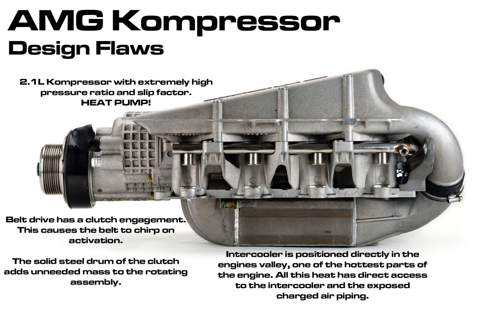

Sorry if my post wasn't sarcastic enough for you to notice. I merely pointed out that I (as a dumb consumer with fist fulls of cash) can't tell the difference. I was also pointing out that they did a great job in showing that the stock compressor has faults, but they left me hangin and wondering who's piston is that. If anything my previous post was a call to action for them to edit and make it more clear on their position. But hey not bad with 2/6 off suit right?
