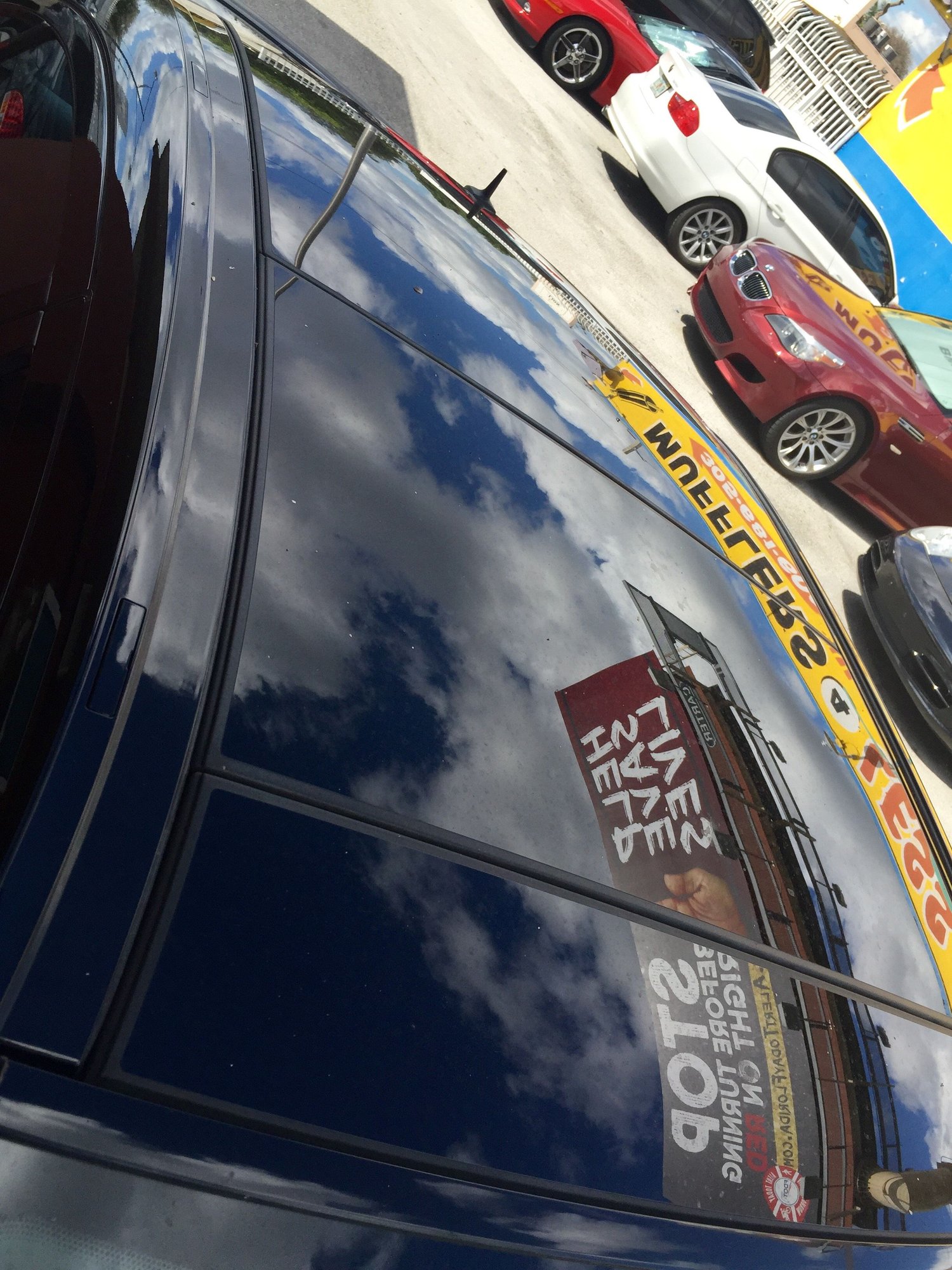

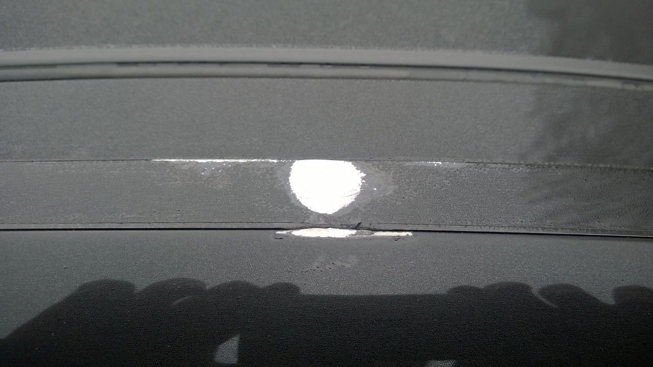

So I took my new car to be detailed yesterday (to a place I've gone since I was 16) and I get it back with metal showing. I went back there with the pictures from when I bought the car (just a few days ago) and the owner claims that there's no way it happened there. He actually tried to tell me that the dealer must have covered it up with a magic marker! Are you f'ing kidding me! I showed him the before pictures which show absolutely no blemish what so ever and he just said it musty of happened in my driveway! The car isn't even registered yet! I'm livid. I think I'm going to have to take him to small claims court.
WTF?
Before
Before

Nov 11, 2014 | 01:05 PM
looks like a buffer burn to me.
Reply 0
Nov 11, 2014 | 01:10 PM
Yep. Same thing happened to my fathers car on the hood. Obviously way too much pressure. No way that could happen in your driveway.
Reply 0
Nov 11, 2014 | 01:13 PM
Quote: looks like a buffer burn to me.
yup, absolutely
Reply 0
Nov 11, 2014 | 01:28 PM
Dude looks like he's trying to cover his *** from having to paint your roof Bro.. That's def a buff burn

Nov 11, 2014 | 02:02 PM
Yeah, it seemed pretty obvious to me too. He tried to say that they only use foam pads and that this couldn't happen. I told him he was being ridiculous and that you could do this with cotton ***** if you attached them to a high speed buffer.

Quote: Yeah, it seemed pretty obvious to me too. He tried to say that they only use foam pads and that this couldn't happen. I told him he was being ridiculous and that you could do this with cotton ***** if you attached them to a high speed buffer.
You need to call them out and tell them that someone on staff is inexperienced in using a rotary buffer and that for those who don't know how to use one, to stick with using a random or a dual-action rotary buffer instead. This business needs to take accountability. Then again, I've seen dealerships try to squirm out of similar situations with their detail services on site...
Reply 0
Nov 11, 2014 | 02:52 PM
Sorry to see this but that's a buffer burn. It's easy to get a buffer burn where the paint is the thinnest, on the edge of any contour on a car. If you look at the edge where that spot is you will see the paint is feathering. No line or drag marks through that spot (vertically or horizontally) as if something drag against the car. Sorry but his excuse "you musty of happened in my driveway " is off base.

Did you mean to post 2 before roof shots or should one of them be an after shot?
Reply 0
Nov 11, 2014 | 05:43 PM
Quote: Did you mean to post 2 before roof shots or should one of them be an after shot?
I meant to post two before shots. They're slightly different angles that reflect the sky different.
Reply 0

Guys, I am a hobbyist Paint Correction Specialist. I want to say that is an extreme burn through. I actually have never seen such a burn that has gone through to the metal. Normally someone would burn through the clear coat on an edge and there would be discoloration to it. BUT.... looking at the picture, notice how the rubber trim gasket is chewed up also, and the actual spot is ground down smooth to the metal. I want to say that looks like a 3" sanding disc mark then chewed up the other areas. IF a foam pad you would literally have to have a rotary buffer on 1800rpm with a 3" or so pad and grind it down with a ton of pressure to get that result. i.e...... would have to be done on purpose for that to happen. Not something with a foam pad that would have happened by accident. Thats my .02 for the detailing part.
OP- the members are telling you the best way. CC dispute to prevent funds being payed to the shop. Police report for property damage can or could be done, but ask the CC company if they want you to get one. Other than that, INS or Small claims court would be the only other reason to get one.
Dispute the charge, follow the companies guidance on the situation, then find a REPUTABLE (maybe custom) paint shop to get that blended in. A pain, but not a hard thing to fix. The only part I wonder about is the rubber strip, that might just be a pain to get replaced.
So sorry this happened. I do high end cars quite a lot for paint corrections and do not carry INS. I do this on the side. However, I am extremely careful with how I go about my work. I do not do anything I have not done before and am careful with wires, machines etc..... I treat it like my car. I just turned down a 458 due to the owner wanted the orange peel taken out. I am not comfortable taking down a Ferrari's Clear Coat to level it perfect due to the orange peel. Too much has to come off and most of it was on the engine cover vents. WAY to much risk. I gave my advice and he decided to ship the car to Ohio to have Esoteric do the work. A proper detailer knows when to say when.
