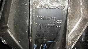

Hello,
I bought this 2004 E55 about a month ago from the original owner which was only serviced by the dealership in Victoria, BC.
One thing I noticed is that the car does not have the cooling fins like this 2003 I looked at.
Am I missing it or did only some E55s have it??
Mine (2004)

the rear casing of the diff above does not look like it has an e55 back plate,
attached picture of what it should look like without the cooler
Attached Thumbnails Missing my diff cooler??-b.jpg   Missing my diff cooler??-.jpg

Mid 2004 they changed the rear diff to a different design (the axles are different as well).

Some of the 2004 (2003 build date) cars did not have the extra cooling fins. Mine does, my friends does not (has the same diff as shown in the big picture)
Not sure why the difference,but I suspect between the smaller 2003 diff and the larger 2004 diff there was a parts supply/availability issue on the assembly line. Remember the E55 was selling like crazy back in the day.
Also there is an updated rear diff cover, the older fins from my 2004 will not fit onto the newer covers. The newer covers use the SLK amg fins- 171 XXXXXXXX part number. The older fins are the "scoop" style with the newer ones being straight fins. They are not interchangable.
I don't think the fins are needed unless you are cruising at sustained high speeds...meaning 100+ for extended periods, just my opinion. But they sure look good from behind the car in traffic!
