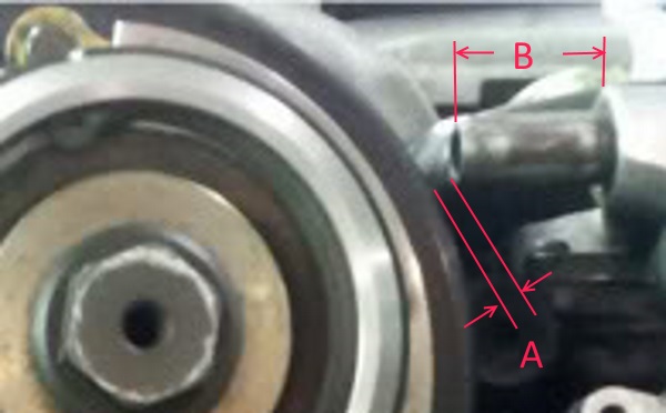

Apparently, some of the AMG55s (later ones, presumably) came with short "posts" (as seen in Starving Artist's reply to the thread a couple of days ago). This comes as a complete surprise to me (an embarrassing surprise). But, I have already begun contacting all purchasers (beginning with 2006 owners today) and I plan on identifying those who have a short post and then providing a replacement that is best suited for their application. Being as this has just come up in the last day or so AND that I don't know yet how many shields for short posts may be required to replace units that have been shipped, I have not decided if I will rework some or make a new batch.
TO BE CLEAR, the original (current) version of the shield mounted on a car with a short post presents NO risk. It is just that with the short post, it is just not the fit that I had intended for this part (and I would rather lose money on this so I can make it perfect for those who bought one).
My plan (for those affected) is to provide a replacement and then have the original returned to me (in that order).
If you have received your scattershield and have not installed it yet, it is simple enough to measure to see if you have a short or long post ... measuring from the very tip of the "post" to the casting it is pressed into (see "B" in picture below), short posts are approx 0.925" (approx 15/16") ... and long posts are approx 1.080" (approx 1 1/16") .
I will be sending an email to everyone who has purchased asking them to measure their "post" (or send me a pic of their shield and post if they have already installed it).
I am embarrassed that I was unaware that this "post" is shorter on some AMG55 cars , I am sorry for any bother this might cause ... and I am grateful in advance for everyone's help in getting this sorted out.

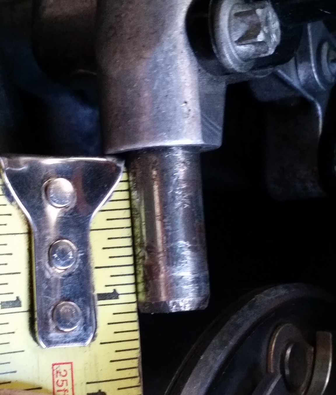

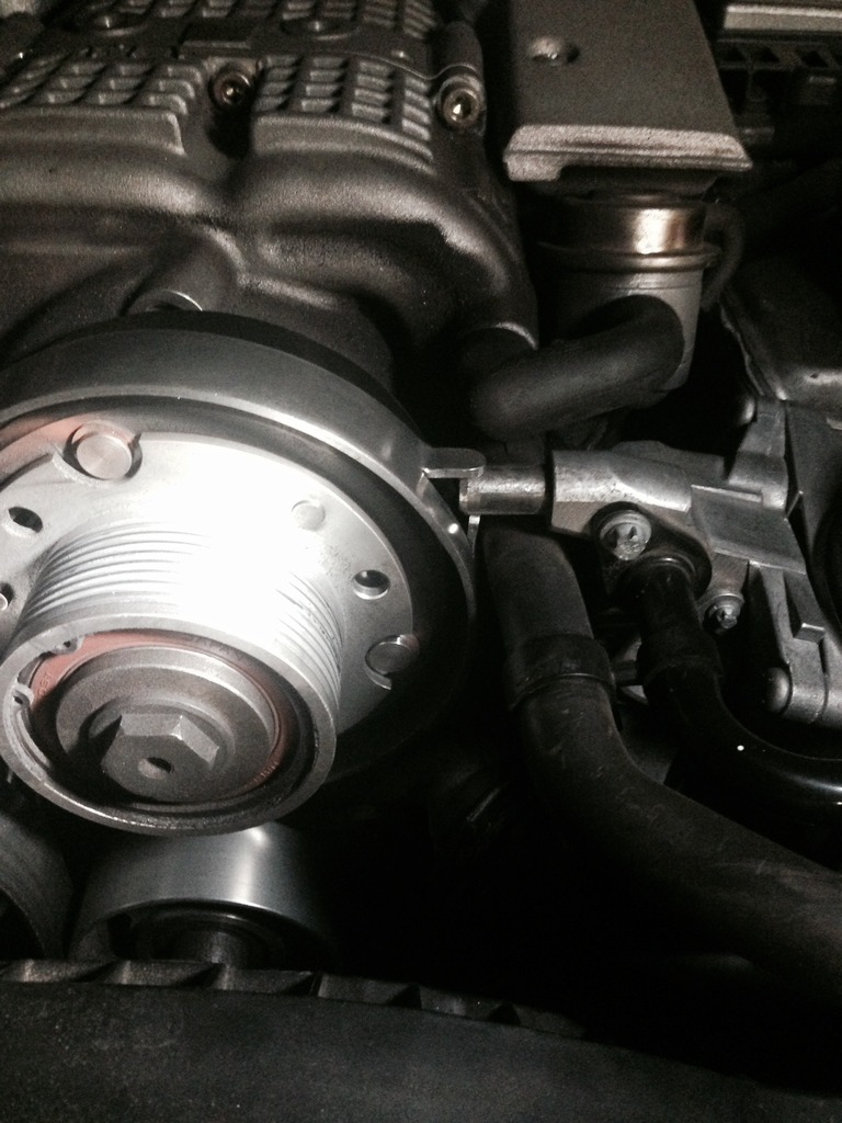

It would seem that some cars have this short post ...
.. the good news for everyone who has a short post is that I designed a new version of the the scattershield this week (with the shorter post in mind) and I expect to have them ready to ship in about 3 or 4 weeks to exchange with customers that have the short post (EVEN those who have installed theirs already). It would be very helpful to get a count of how many customers have short posts (so that I make enough ...) .
To be clear, there is no risk associated with running the current shield on a "short-post" car (so don't worry about leaving it in place until I send you the "short-post version" as it IS currently providing the protection that it was designed to provide). BUT, in any case, whether you have installed it already or not, I want to provide a a shield that is designed specifically for your post length.
I have sent an email to all who have purchased a scattershield so I can identify which customers need the short-post shield.
I appreciate everyone's help in getting this sorted out and apologize for any inconvenience.
Cheers,
Chris
I've added some pictures that make it easy to see if you have the long or short post (last 2 pics are the short post)

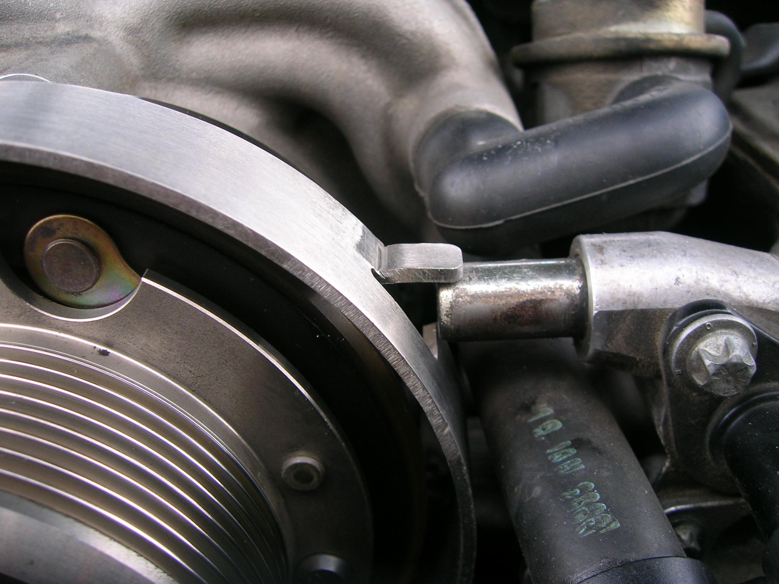

Standard version as supplied to people with "longer shafts "

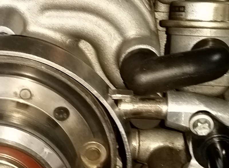

AMG55 Scattershield for Supercharger pulley-e55-20new-20cage_zpsxczkm1ee.jpg
Turns out I have a short shaft ( been told that many times !! )
So they make this version, I like it because it locates even better and the shield can not move up or down.
