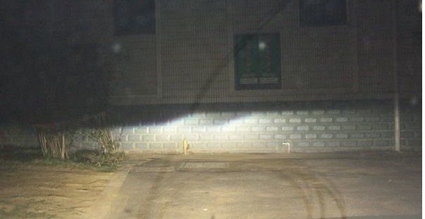

The stock Hella E55's have a pretty crummy cutoff. If you color mod the Evo XR you can have a 2-3" blue line at the cutoff at 25'. I have mine setup that way and it looks killer. The color flicker is even better.

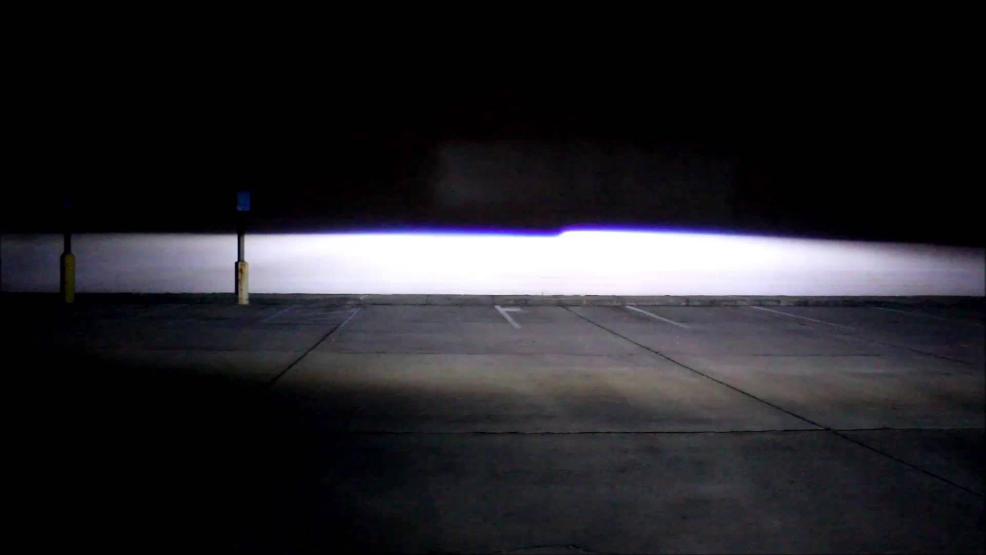

Hella E55 is the HID projector in your E55 headlight. It's a 45* cutoff or the European headlight code (ECE, E-Code)
Picture of stock cutoff/projector.
Here is the EVO XR Direct replacement. It's a clear lens projector that is a replica of the stock projector, however the beam pattern, high beam, width and distance has been improved. (note this is one projector)

WOW! That looks like i always wanted it to look.
Is that projector compatible into my Bi-Xenon CL C215 06/2003 ?

I'm not sure what the CL uses for projectors. If you can pop the cover off the back of the headlight and take a picture of the projector I can tell you. I am probably safe to assume a Hella E55 since MB loves that projector. I just want to make sure.
