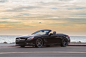

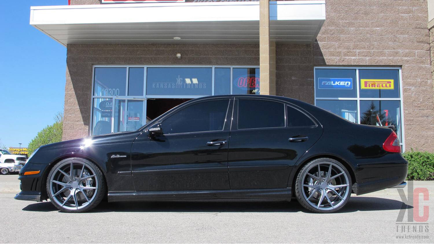

Here's some pics I found online. I'm assuming those that have it went with 19s.

Pics

One of those cars is mine. The wheels look great and are holding up well. I went with 20x9.5 +32 and 20x10.5 +42. No spacers required, but I did need to roll the rear fenders to fit the 305s.
