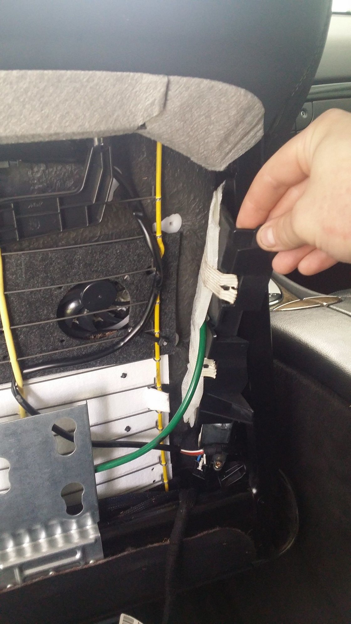

If it's the bolsters that are on the back portion of the seat on the sides (parts that hug you as you corner) then yes it's easy to get to/get out, push the seat forwards and tilt it forwards.
Then get in the back of the car, there are a couple of torx screws on the bottom of the rear cover, undo them then pull the bottom towards you and down and it will come off, you will see at the bottom of the seat a black box with the hoses going in to it, you will also be able to see the bolster inflatables, they will have a white paper like protective covering on them and they are installed in to a plastic bracket.
To get them out you will see there is a metal spring frame that covers the back of the seat, unhook it from the sides of the chair, then you can undo the screw holding the plastic bracket which houses the bubble inflatable.
The white protective covering over the bubble will have the part number on it if I'm right the left hand bolster is this part number A211 910 01 75

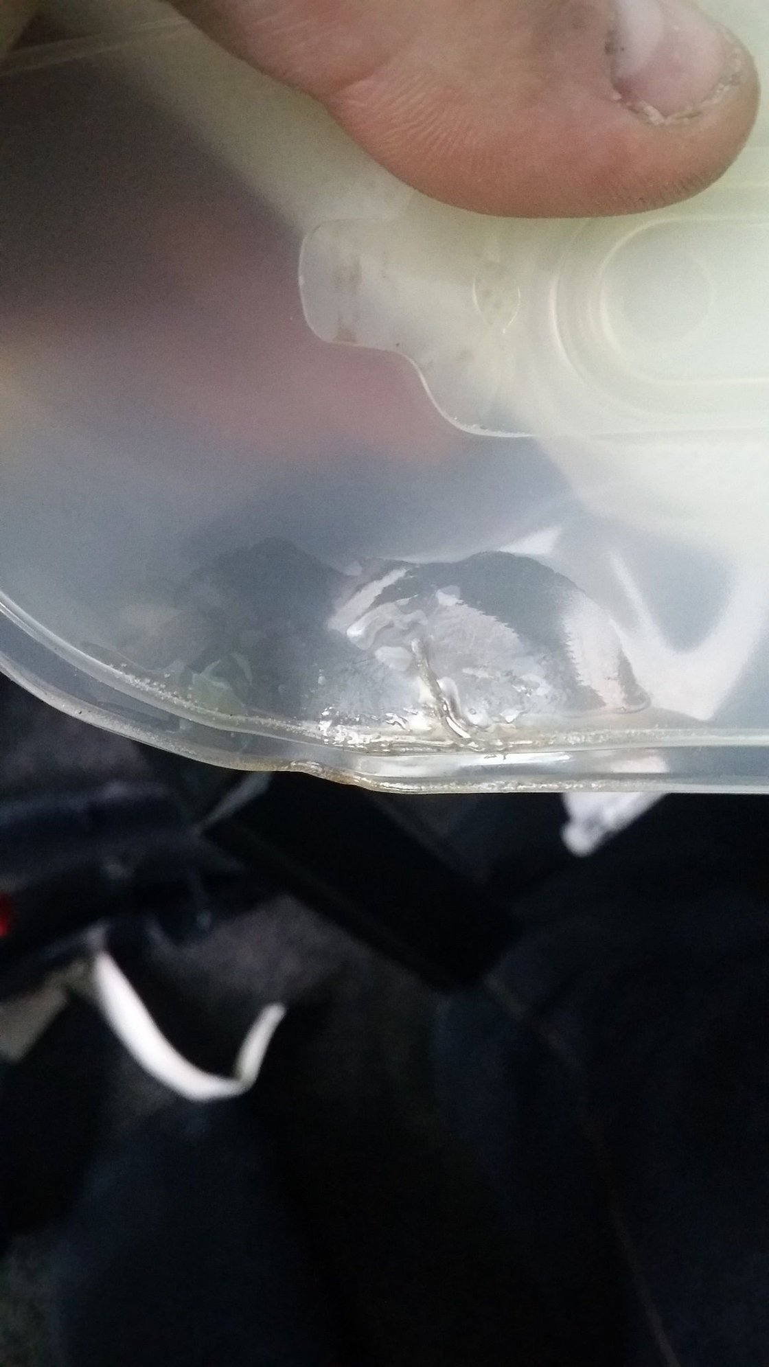

Just took my drivers rightside bolster out and got it fixed. I melted the plastic and got it to hold, atleast for now.
Its on by one screw and needs a little wiggling to get out but its easy.. just like said before here.
Heres some pics.
Can someone confirm that part#?
I cant read that..

I would say it took me about 30 min to get it out. But i was going back and forth the car and my garage to get some tools and i was really taking my time. So if i'd do it "in a hurry" its propably 10-15 min max
Take the back cover off, two tx20 torx screws at bottom. Then take the sprigs that hold that metal thing on place and then you can get it out. Its on by one screw from the top and on the bottom it has just a fitting that connects to the seat frame

You can always try. But if its leaking like mine did from the seam, its pretty easy to melt it.

I got to it tonight. Mine was the same as yours.

I made this repair on mine tonight. I used Aquaseal by itself. I think it was developed for wetsuit repair. Regardless, worked great for me. Bonds well and stays flexible. Covered the hole and let cure for 24 hours. No more leak.

Excellent write up! I applied to my E55 this morning. Mine's a 2005 and the plastic adapter holding the bladder is riveted to the metal frame of the seat. So I had to pull out the bladder by squeezing my hand in and pulling it out through the front.
Small rip in one of the seems and managed to fix it by melting the plastic carefully with a soldering iron.
