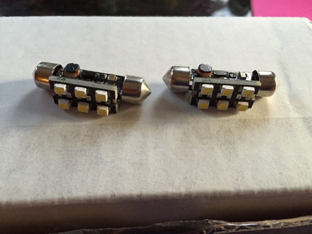

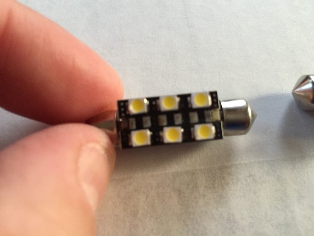

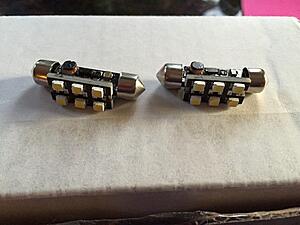

Ordered these 5000K 38mm festoon LEDs from the onsite vendor AZN Optics
http://www.aznoptics.com/index.php?m...jbs0qldj6v9lq6
they're $20 ($10/ea) and install was SUPER EASY!

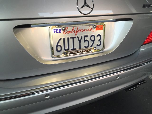

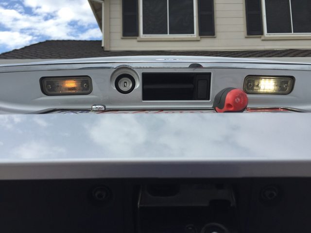

Tools needed:
#2 phillips screwdriver (short length)
flat screwdriver (as a prying device)
1. pop your trunk
2. remove the 4 phillips head screws from the license plate bulb covers
3. with the flat screwdriver, pry the lenses off (the bulbs will come out with the covers)
4. remove the old bulbs, and replace with the LED festoons - remember to face the LEDs DOWN toward the license plate
5. pop the lenses back in and redo the screws - voila! you're done!
