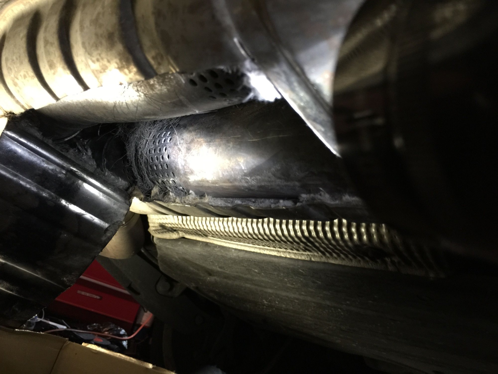

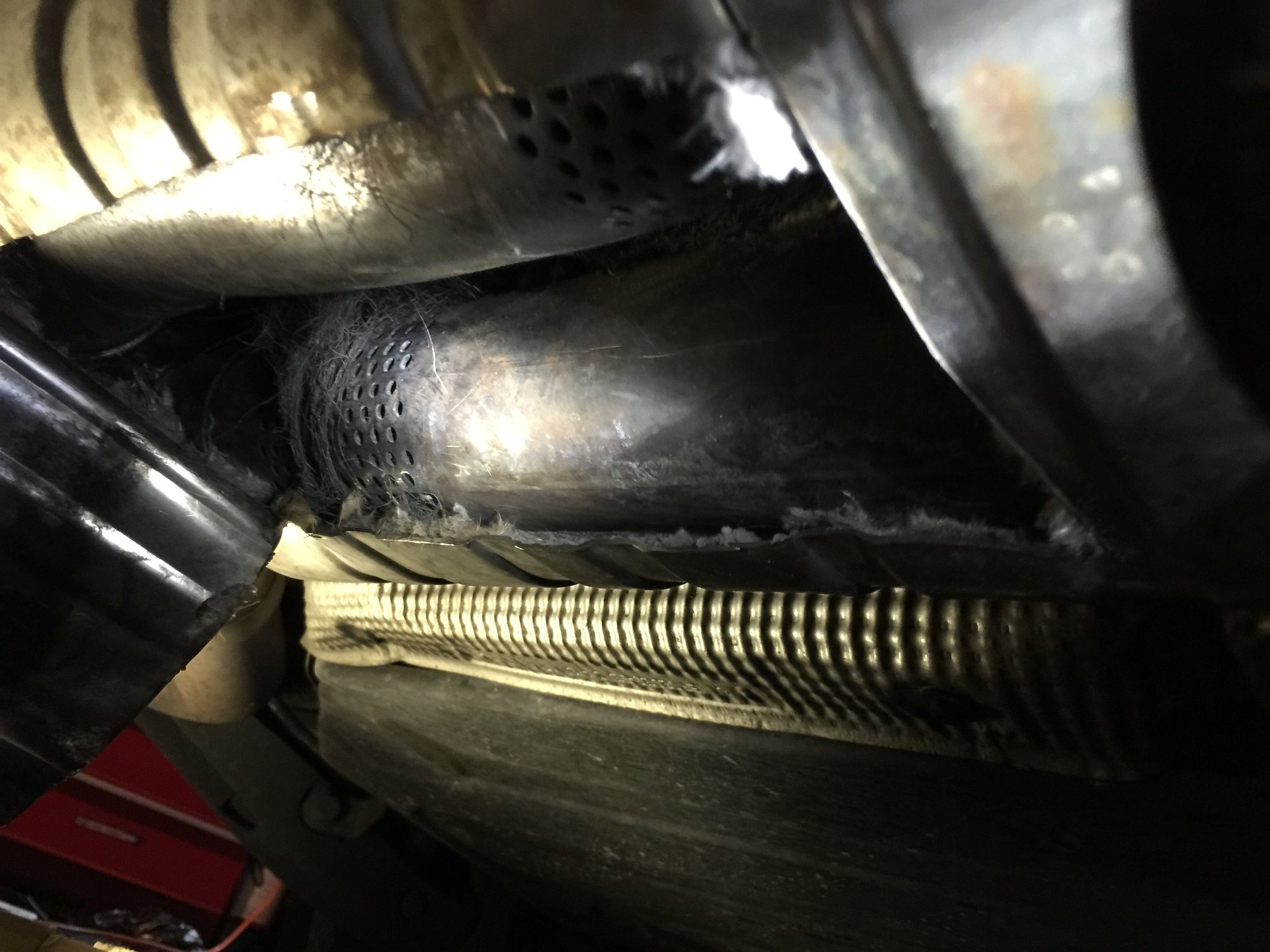

Hey guys, I want to share some info that you may or may not find useful but hopefully someone benefits from at some point
I was planning on cutting out the center resonator and welding in straight pipes over the weekend but curiosity got the best of me after I came across some threads about gutting the factory mufflers. I decided after finding nothing but speculation to find out what was inside the stock resonator. Unsurprisingly it is very similar to the stock mufflers in terms of the sound deadening material. What is interesting is that the tubing running through it is almost identical in size to the rest of the exhaust, the only difference being the perforations in the tube like what is found in the mufflers.
After my investigation I yanked out as much sound deadening as possible and welded the resonator back together. The results are pretty much as expected... Not much difference in sound other than more noise on the overrun when decelerating. I did this with the plan to run straight pipes if it didn't turn out like I wanted but between removing the sound deadening from the mufflers and the resonator I'll probably leave the exhaust alone for a while with the exception of some headers in the future.
One way this may help some of you who are planning to remove the whole resonator is to instead cut away all of the resonator housing and then have an exhaust shop replace just the 5 inches or so of perforated tube on each side... This should lower the cost significantly if you cut away the housing yourself.

no. read first post/look at pictures in first post.
Resonator delete will not increase or decrease horsepower. Just noise
