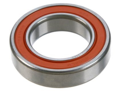

That looks like the right one the two I got are thicker in the middle race so only 30mm inside. That looks like the one that came off except mine has black seals and is a *** brand bearing with the number 805259
So does anybody know where I can order this bearing from that is for SURE the right one? As if I end up with three of these wrong bearings im probably just going to start a bearing shop...

MB provides Red or Black, that depends on production line:-
MB part #: "008 981 51 25",,
*you can get them from dealer/E-Bay/ECS tuning/AutohausAZ..

Im not sure if your saying you have another bearing or what?
That picture is the same wrong bearing I already have I can tell straight away due to the thickness of the inner race. My original bearing is like 2.5mm thick in that area whereas these wrong ones I keep getting are 4-4.5mm thick in that area.
What I need is the same dimension and looking bearing with a 32mm hole in the middle of it!!! The one you have pictured is clearly a 30mm hole one.

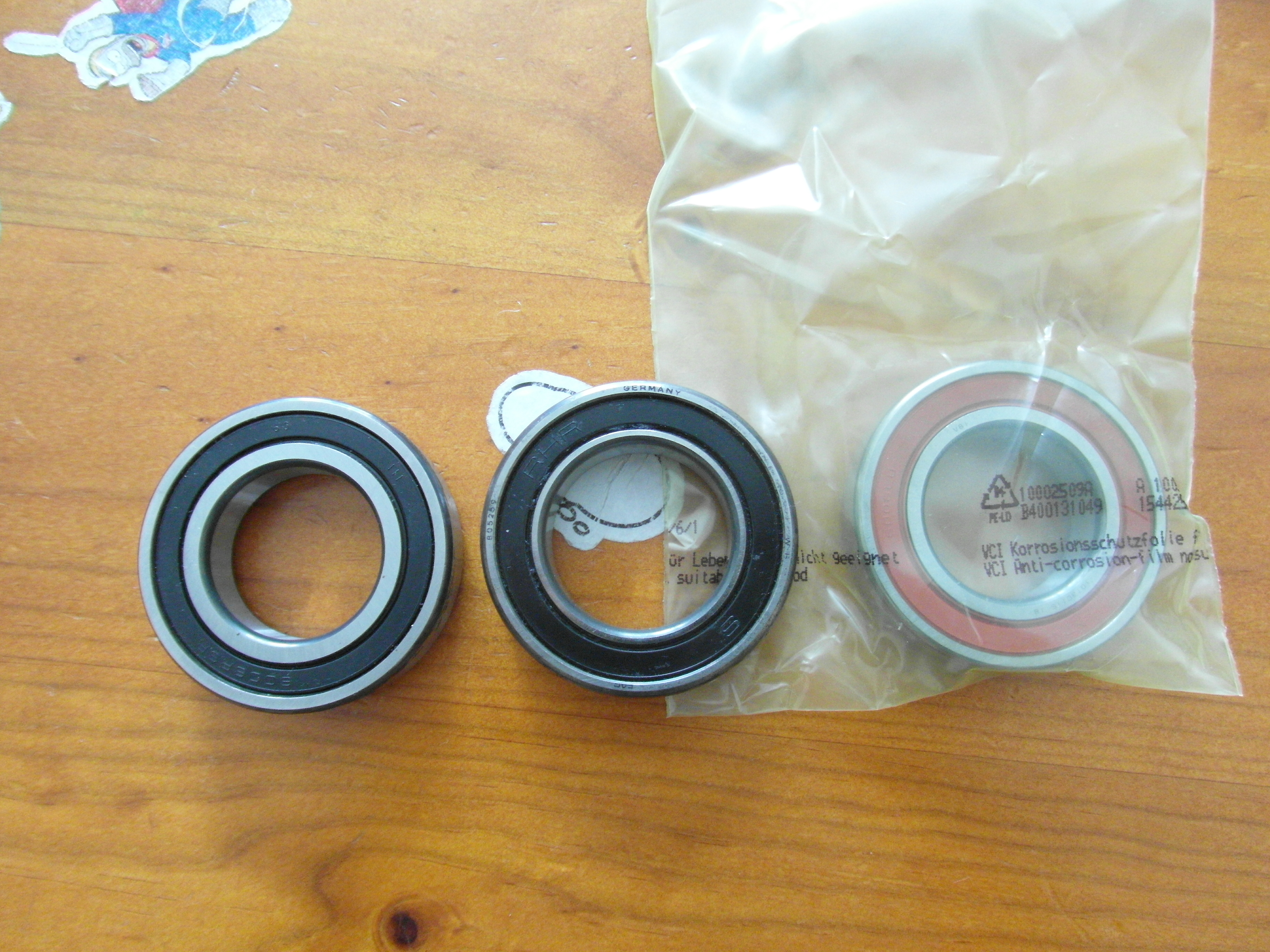

The bearing in the middle is what came off my car.
You can clearly see the difference.

Uhhh,...... that bearing doesnt fit!!
Im not sure if im not being clear enough?
The orange seal bearing I pictured above is from mercedes NZ in gen oem mercedes packaging. (its made in taiwan and cost me like 70 or 80 USD!!!!) So yeah its getting sent back!!!!!

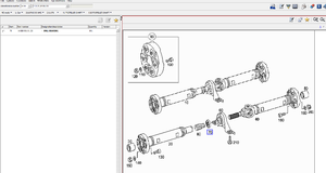

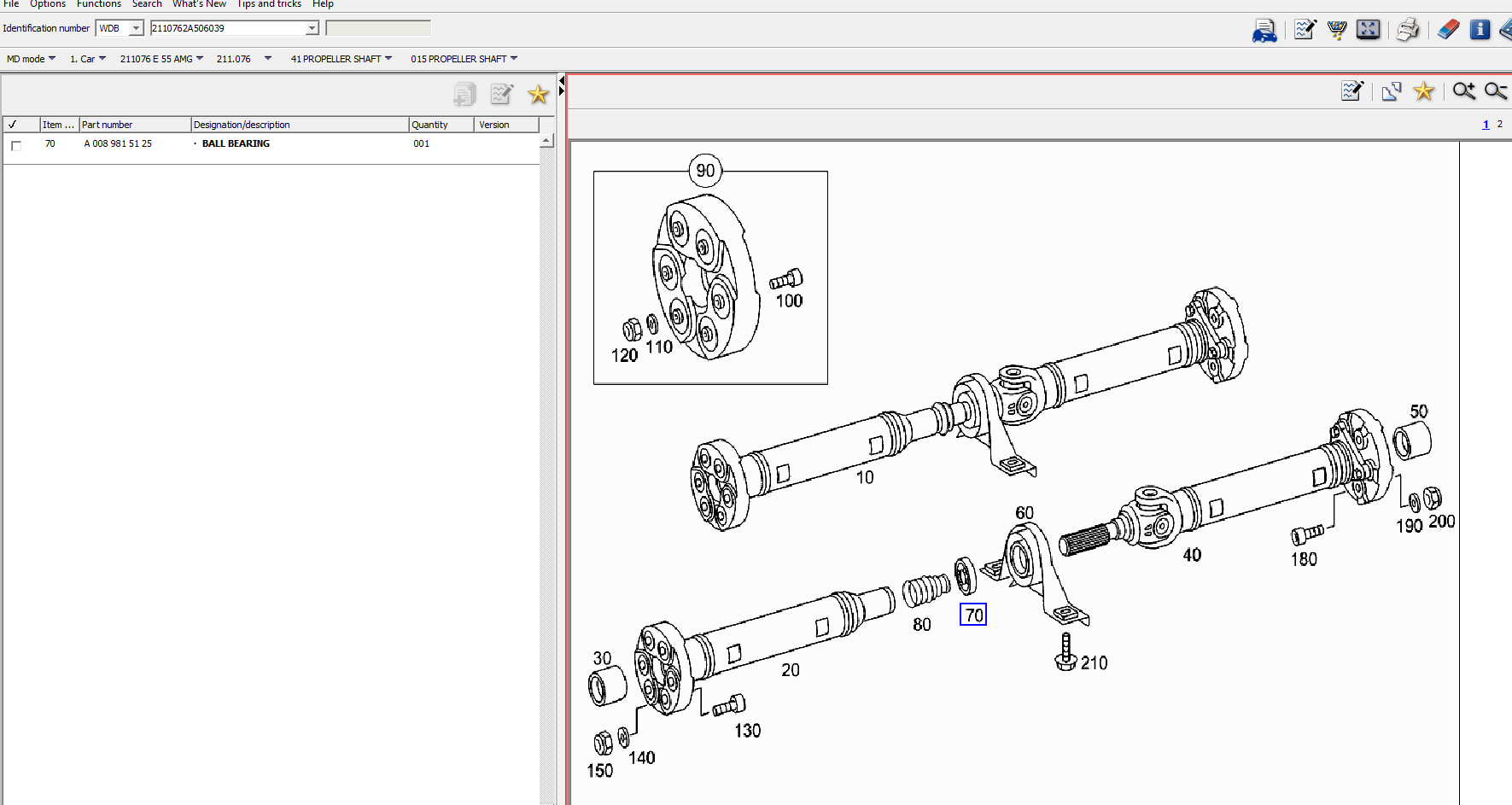

In post number 9 there is an exploded parts drawing its number 70.
Mercedes has put a different driveshaft in my car for whatever reason... I would expect they've run out of the normal one everyone else appears to have during production and started putting these 32mm driveshafts on instead of the 30. That seems to be the only simple explanation to me.
I have looked at the drive shaft and its dated 2004 the same as my car so its most likely the original driveshaft.
I am dealing with a mercedes dealer now here in NZ trying to sort this out.

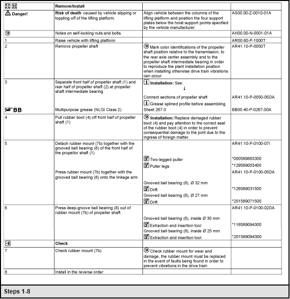

Ok. Well, I pulled this info for the R&R of the bearing.
Ask your contact to look up the details of the 32mm bearing via AR41.10-P-0100-05DA. It should list compatible vehicles within the document.
Old Jan 29, 2016 | 12:49 AM

^^ Thank you this is what im after!

If you look at the wis documents above it clearly shows there are two different bearings.
I think its just a case of finding a parts guy who's willing to dig deeper into wis and all that guff or send them a copy of that one above and get them to search for that bearing off that document.
I ended up ringing about 4 separate MB dealers before I got someone who seemed willing to go the extra mile.
