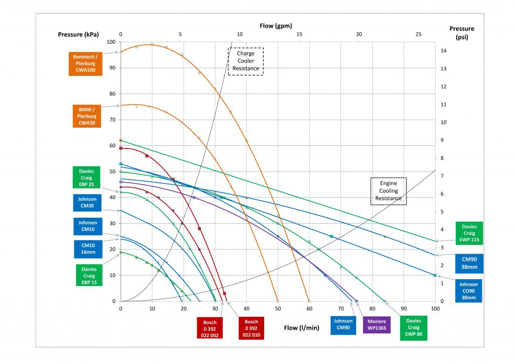

That is a pierberg CWA-100. It a great, high flowing pump. It is essentially the same pump used on all newer AMGs (with a different connector).
I have compared that pump head to head with the bosch 010 (and the peirberg CWA-50) and a couple of others and it is by far the best flowing pump for the money (particularly when measuring Flow at typical charge cooling system resistance).
After testing various pumps, the CWA-100 is what I ended up using on my SL55.
I would not hesitate to get this pump from VRP it is a very good price for a great pump.
hope that helps,
Chris
attached is a graph comparing it to various pumps. I did not create this graph, but all of my testing on various pumps, agreed with it.
