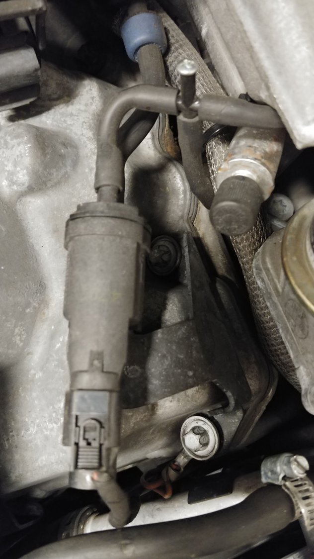

Good advice, I appreciate it. So I pulled the engine cover off and noticed this. I called the PO and asked him about it. Apparently the hose cracked and disintegrated, so he capped it. He mentioned the other end goes somewhere under the blower. So as a result, I am thinking I will pull the blower, replace all gaskets and fix it properly...unless someone has a better idea.
...sorry- stock TB and no data logging just yet.

I will need to double check to be sure, but I'm 85% confident on mine, that that T valve is not a 4 way on mine. I have removed the SAI so can check the parts box in the morning.
Thanks very much, I appreciate it.
