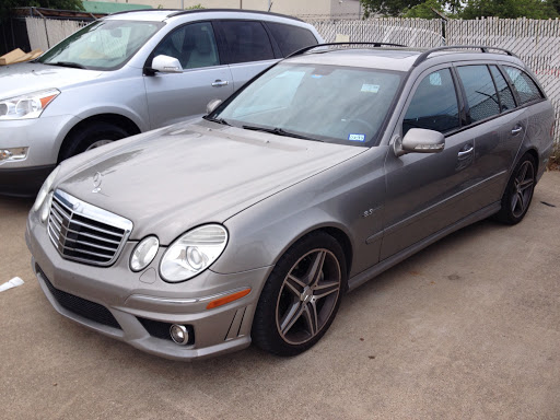

I am in the process of buying a 2009 E63 Wagon with ~105k miles for ~$20k.
It's from a legit dealer and the price seems very good. All of the records are clean, etc.
The dealer is providing me with a written guarantee that it's not a flood car.
Is there anything else I should be worried about?
