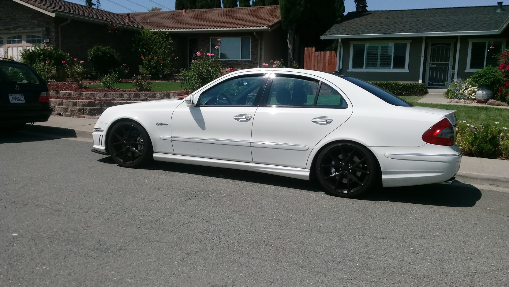

Originally Posted by Max.H
Daamn, I heard they are 2 weeks out, anyone know who I can buy them from or something similar in 19" ? Thanks!
The Niche Misano is similar in design and can be bought from CarID, who is a sponsor here. I originally wanted the Verde Axis, but when I was ready to buy they were a month+ out so I went with the Niche wheels.
I had them on my E63 in matte black but decided to go back to the stock wheels. I'd be willing to sell for a good price too if you want to come up to the SF Bay Area to get them.
They're dirty as **** in this pic.
Attachment 440482

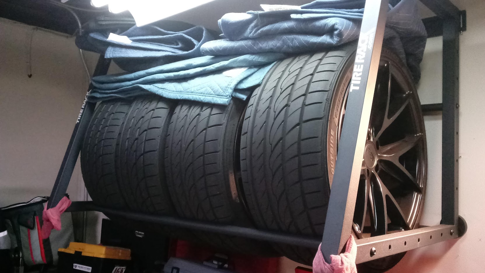

A pic showing the tires I took a few minutes ago. I'd also sell the Tire Rack tire rack if you're interested in it too. The wheels/tires only have about 5,000 miles on them. There is some curb rash on the right rear wheel. My g/f just had to have her Starbucks from the one with the most ****ed off drive-thru. It's not too bad though.
19x8.5 et34 front w/ 245/35-19 Sumitomo HTR Z III
19x9.5 et35 rear w/ 275/30-19 Sumitomo HTR Z III
19" staggered Verde axis wheels for E55 AMG, Anyone know what offset needed?-6wjr6ku.jpg
I have zero interest in shipping the wheels/tires. I'll just put them back on the car when the current tires wear out or sell them with the car when I eventually get off my *** and do that.

Came across another pic...
19" staggered Verde axis wheels for E55 AMG, Anyone know what offset needed?-bhvc4el.jpg
