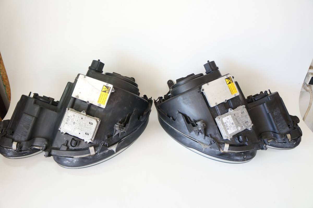

I’ve found a nice pair of used OEM adaptive xenon headlights on Craigslist. No clips are broken. I wanna buy them.
My question:
Are all adaptive headlights bi-xenon? Can you tell if these are bi-xenon by looking at the photos?

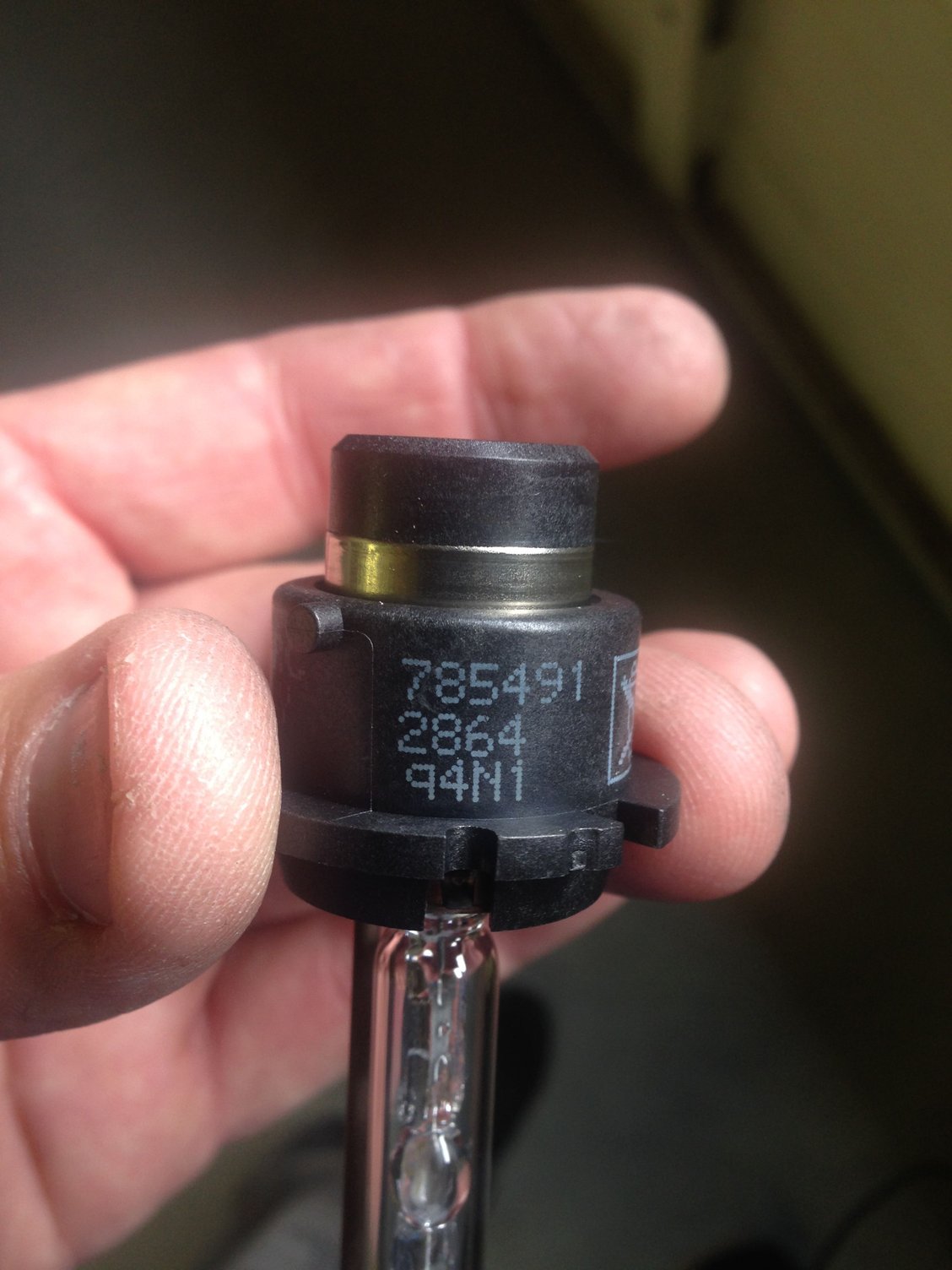

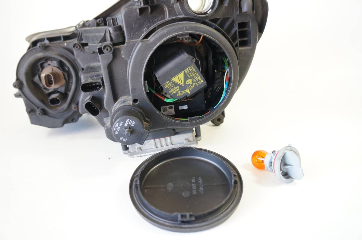

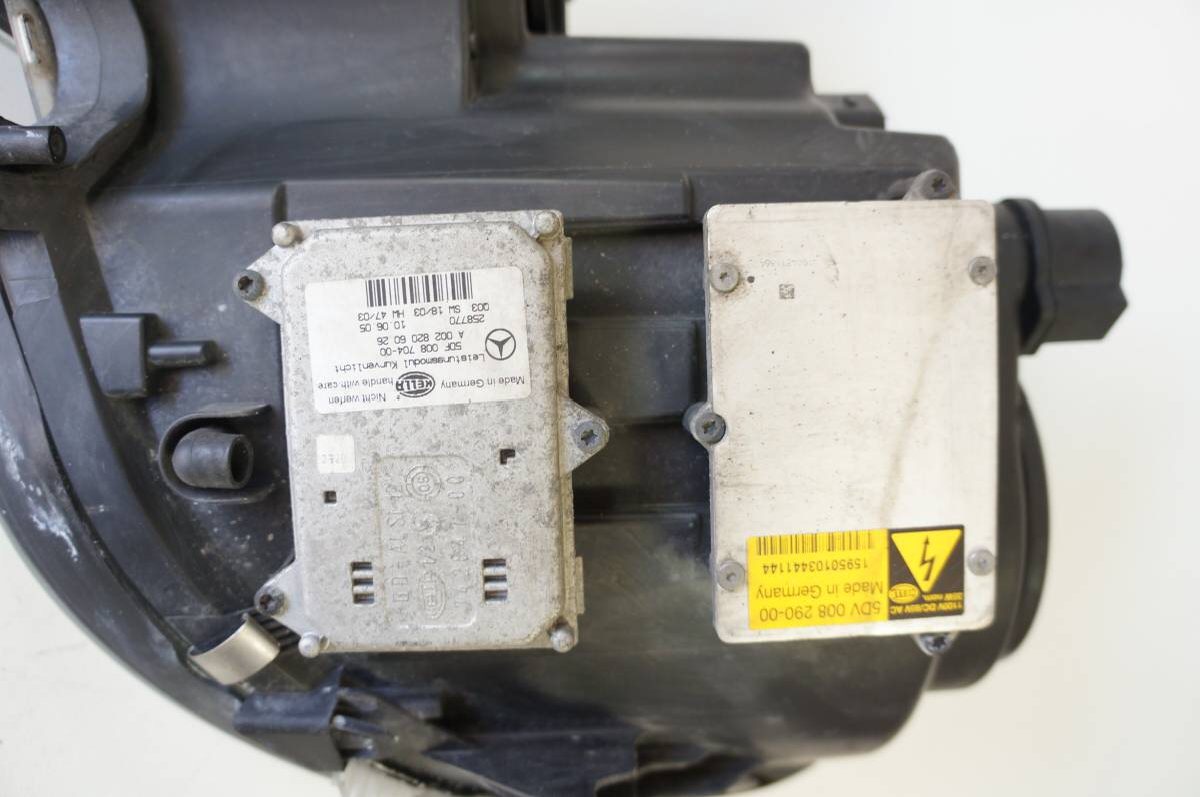

Your first pic has the part # a 002 820 60 26 is showing that as an adaptive headlight control module.
In your 4th pic it looks like it says xenon on the face of the bulb holder.
They look like the same numbers that are on mine.
2005 E55
I believe these were the original bulbs.

Yes they're xenon. Halogen headlights wouldn't have the modules on the bottom of the lights.

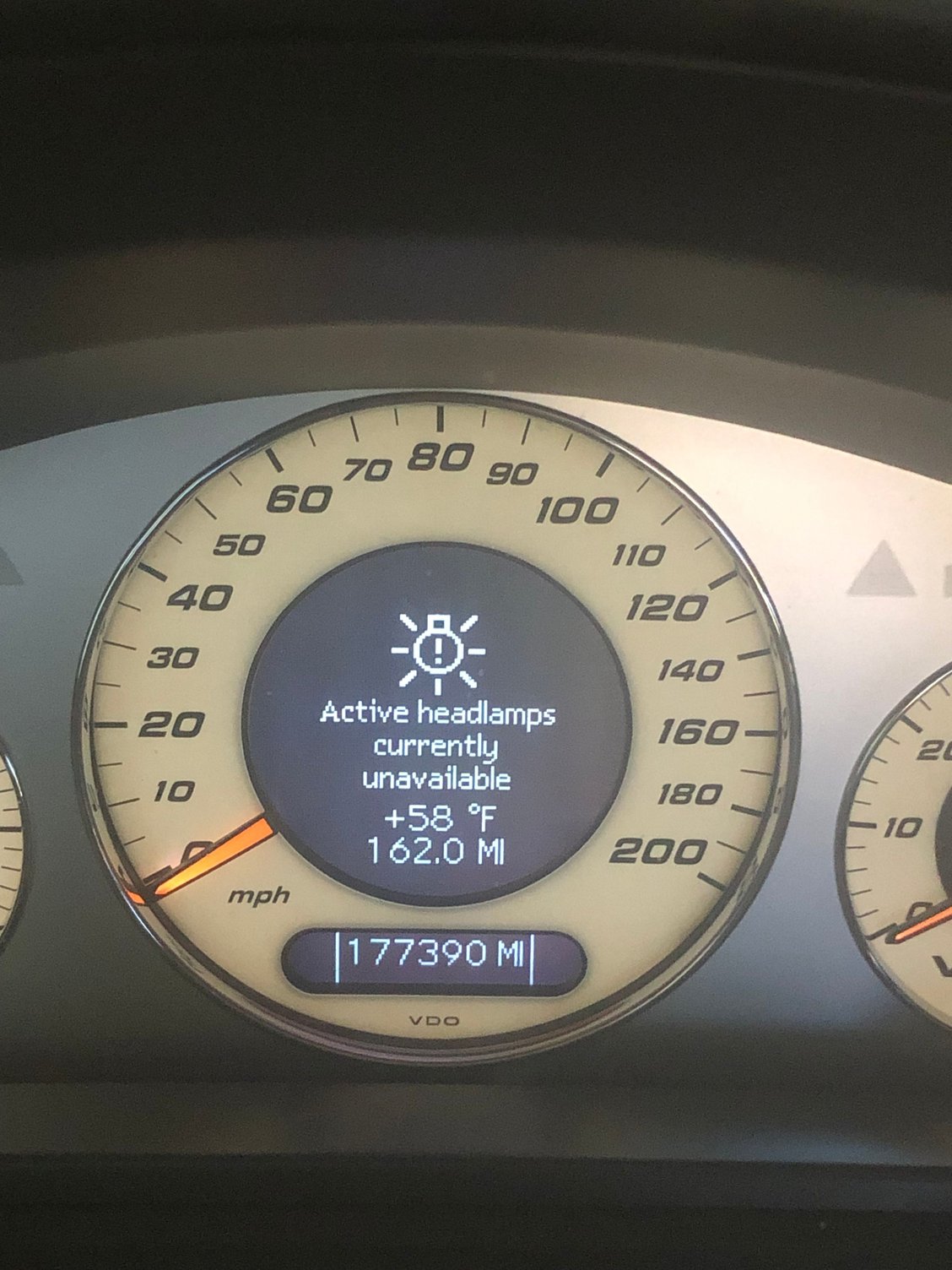

I have factory HID Xenon headlight system on my 06 E55 and it’s not Bi-Xenon. I was thinking to do a Bi-Xenon retrofit kit on mine but decided not to. I hardly use high beams any, why spend $200 bucks? If you got halogen then definitely switch to HID Xenon at least and then get the kit to Bi...if you really need it.
The photo above showing message on my active lights not functional due to bulb. So, think I have active system.
btw, how much for them lights on Craigslist?

Oh, I fixed light, turned out wire was loose.

okay, just did a physical check on my high beams. When car is on and light switch is on auto, I turned on high beam and took a look at front of car. I don’t see my high beam bulbs come on. When I turned on fog lights, the high beam bulbs is lit when I turn em on. Then I shut off fogs and switch back to auto and ask someone to verify if my high are flickering which she confirmed. So I believe I have Bi-Xenon but going to dealer to confirm. Tested while waiting to pick up kids from school.

Thanks Raymond g, I recently had the opportunity to dissect my headlights assembly to change out projector lens along with some minor cosmetics. I didn’t noticed any shutter but then I wasn’t looking for it at the time. I’m just going to call up my dealer and verify with VIN. Will update.
