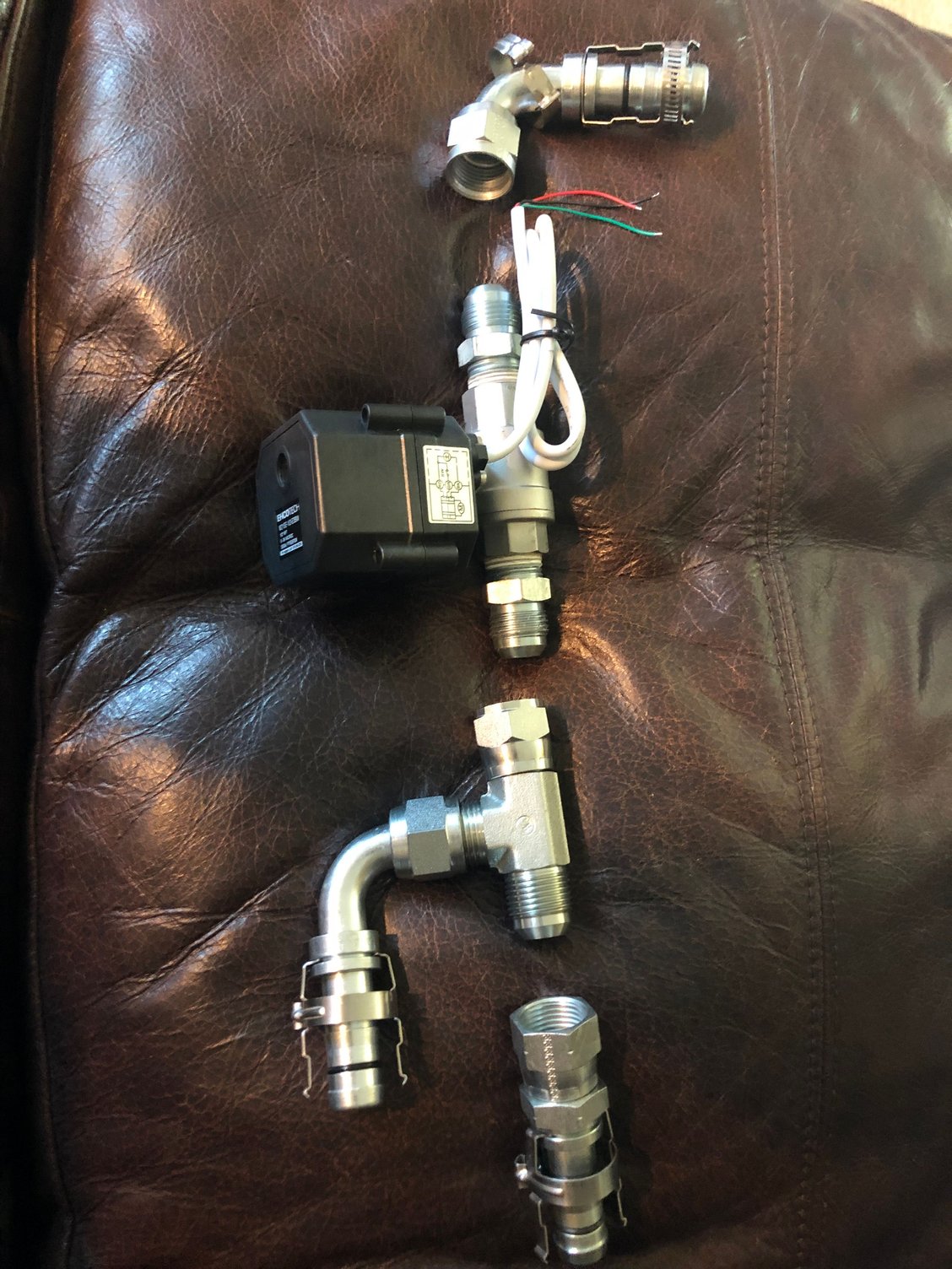

When you get a chance and if able, please post some photos of KC “T” fitting and drag kit for effects and their install location on AC lines.

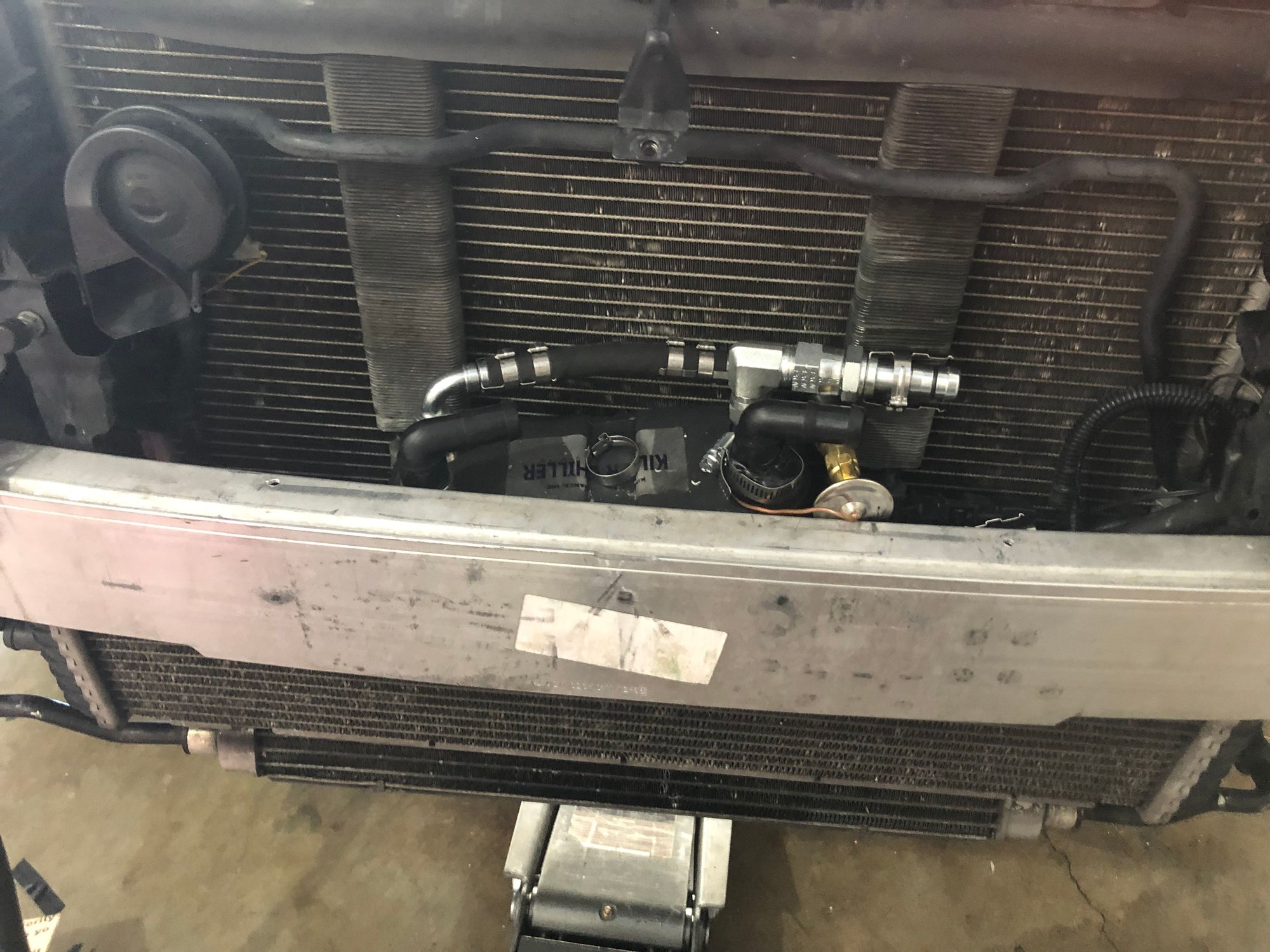

Sep 13, 2019 | 12:52 PM
Update: Thanks to Drothgeb for all his guidance on a successful install! And to Trabots for his inputs.
KC installed with drag kit (waiting to wire up drag kit). Installation wasn’t to bad, evacuate ac, cut ac lines, install T fitting and drag kit is a pain when tightening connections on drag kit due to lack of space; need 1” open wrench to do so with NO Teflon tape. Fittings on drag kit according to Joe Kincaid “...are SAE conections. They are made to seal up when you tighten them down.” The smaller T fitting is a pain to insert into ac line even with huge amounts of PAC oil; it takes a lot of strength to fully insert it. I barley got the tips in. Went to recharge ac and got major leak at drag kit connections. Tighten it up and G2G with ac recharge! Cabin ac blow cold still and IAT below ambient with quick/instant recovery. Insulated ice tank and all hoses and HEs deleted. Mpg fluctuate from city (10-13) to hwy (18-21). 63* is lowest IAT seen so far with 72mm fixed pulley, will continues to monitor both IAT and coolant temperature.

Drag kit with T fitting, almost a foot long and not a lot of room by the firewall to work with. Tighten those connections up!
Decided to mount KC in front, got lazy and still debating to remove SAI pump and relocate KC there. Maybe better performance by moving it. And it’ll look better.

Sep 13, 2019 | 04:46 PM
Not lazy I did the same things 7 years ago but more hidden with Distronic in front.

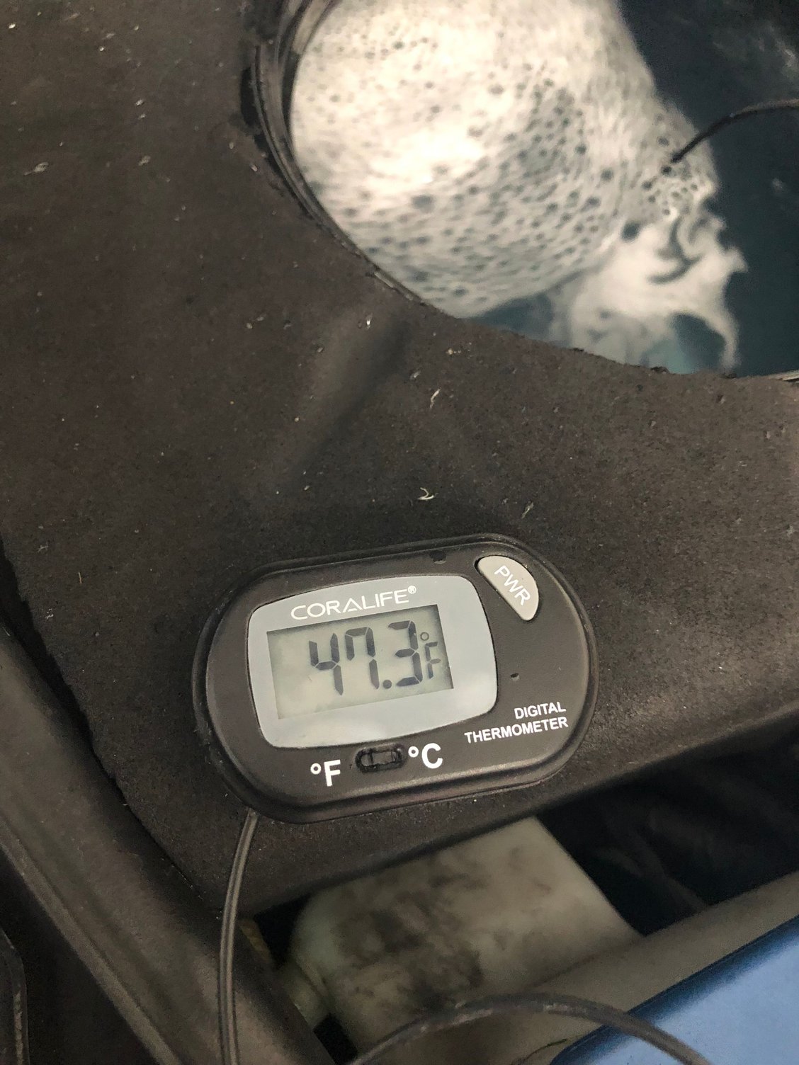

Sep 29, 2019 | 11:44 PM
Drag kit installed
Update:
finally installed drag kit and saw major improvements on tank fluid temp and IAT when it’s activated. The major downfall when drag kit on is cabin ac is nonexistent but that a known.
Also, I’ve injected three cans of 12a as advised by Joe Kincaid and seen decent improvement on IAT and tank temp. Tank temp dropped from 59* to 57* and seen IAT in the 60s when cruising 40-60 mph. Haven’t taken out at WOT due to tranny acting up.
See below photos on numbers with drag kit on; this is during cold start with car in garage hood up.
Reply 0
