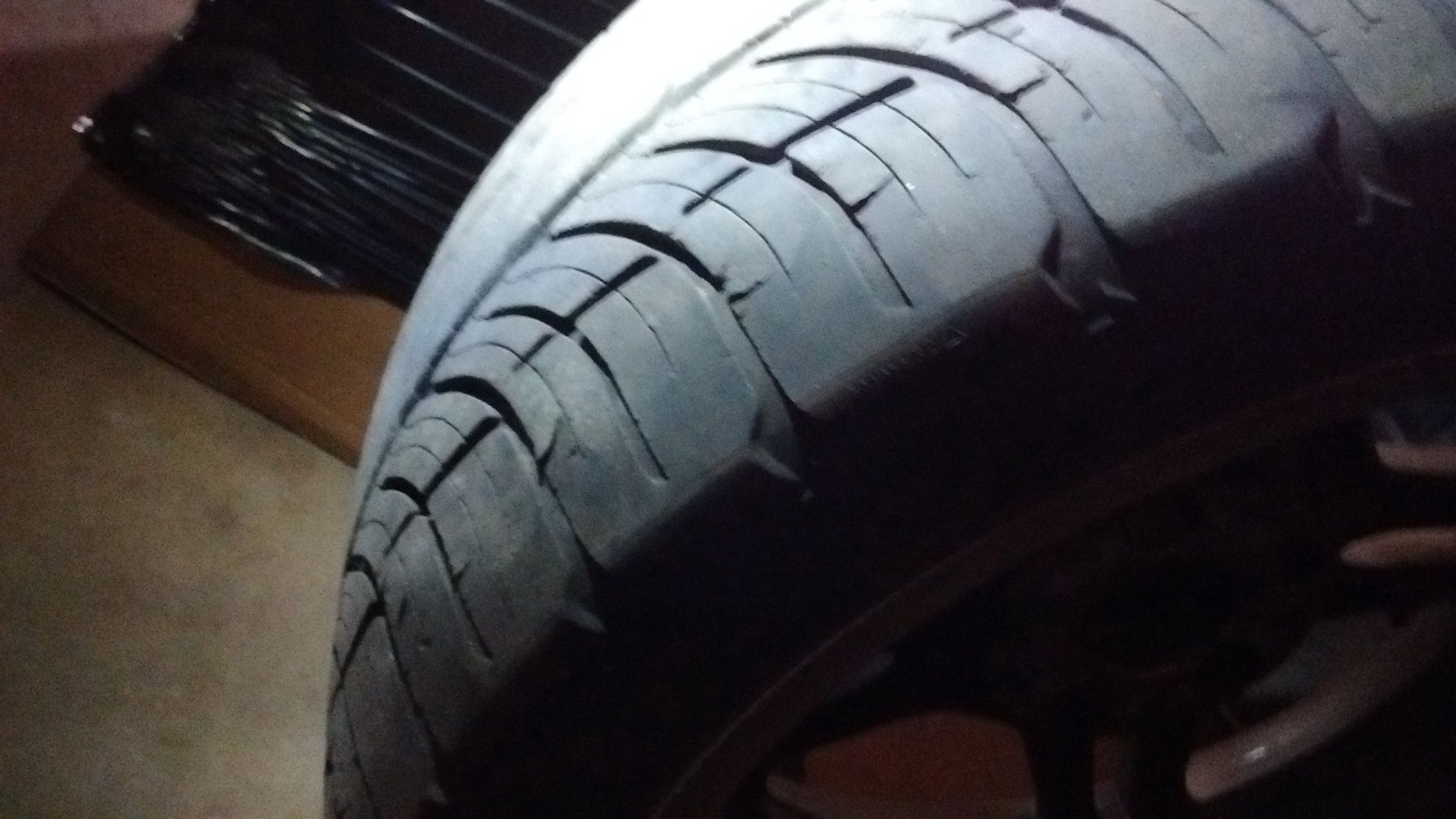

Photo attached shows the wear pattern caused by a bad ball joint and/or bushing. In my case, it's the ball joint on the front lower control arm (aka the thrust arm). The tread blocks begin to "peel" back on the tire. Only 72,000 miles ago I had the same wear pattern on both inner and outer edges of the tire; in that case I had bad ball joints on all control arms plus worn bushings. For all the vaunted Mercedes engineering hype, the suspension on this car is pretty sad when it comes to durability. Front and rear suspension rebuilt at just shy of 100K miles and now a partial rebuild at 172K. FWIW, it also appears I could have dialed in just a touch more toe-in. This tire has 36,000 miles on it and I maintained toe at 0.5mm in. When I align it this weekend I'll aim for ~0.75mm in on each side and see how it goes...

My issue was the rear camber, as I had excessive wear on the inside of the tires, and the other edge looked new. I since then, had a 4 wheel alignment done, to correct the rear camber.

Very disappointed in suspension component longevity. Everyone screams, “it’s a high performance, 2+ton sedan! What do you expect!?” Well, I’d expect a little more r&d into the components to combat the weight and power of the car in the first place. It’s certainly frustrating. After just replacing most of my front end (as you saw) I’ve got a pop coming from my front driver’s side; guessing I have an issue that resulted from installment but we will see when I tear into it.
That thrust arm is a pain since everything attaches to it but maybe you can press out/in while it’s on the car!

I remember now, I did in fact replace my front thrust arms several months ago. I nearly forgot about it, one of the ball joints was bad, so I replaced them in pairs. Certainly wasn't a cheap fix.
